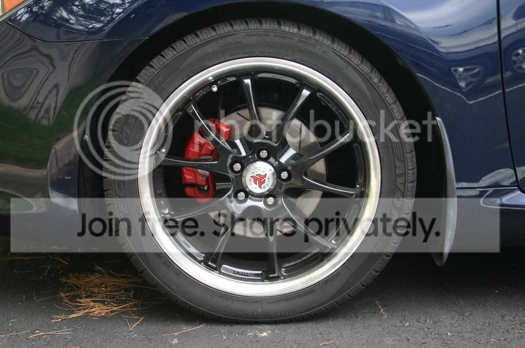

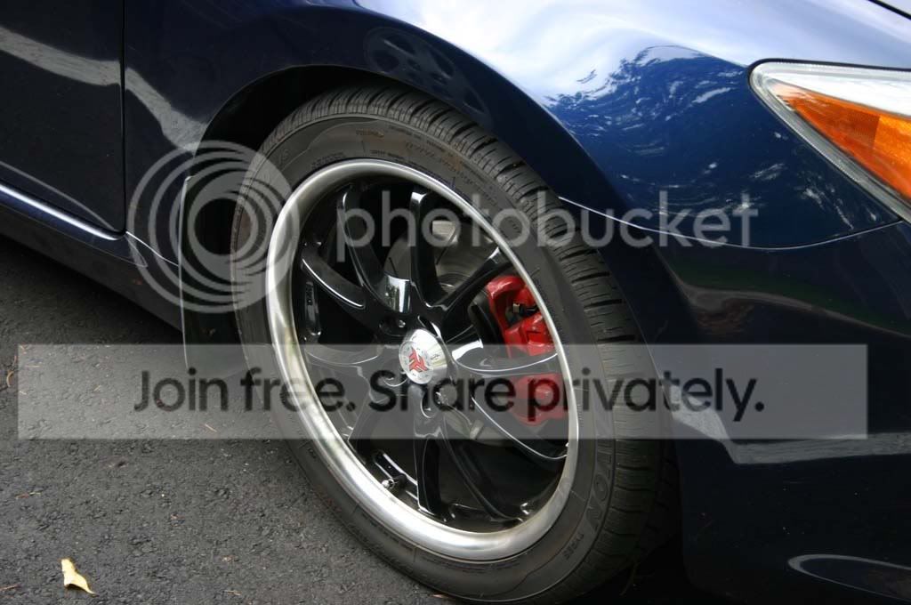

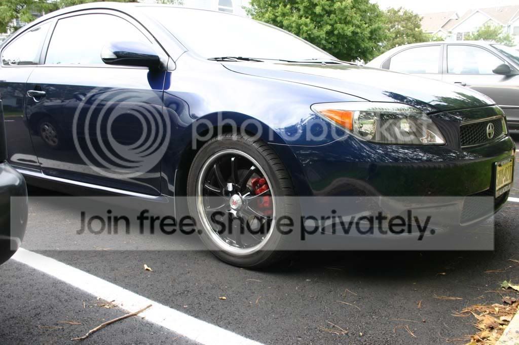

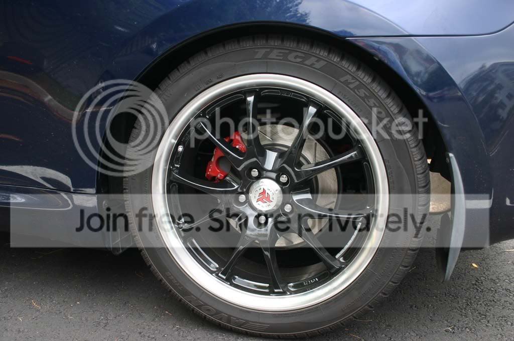

Finally got my Stoptech Stage II Kit installed! Thanks to my Scikotics crew (Matt, Ed, Karl, Gary, and the rest) for helping me out with this!
Removing the stock Calipers & Rotors:
Receiving Instructions on the brake lines (Gary, you're a lifesaver):
Some horsing around of course:
Rears are on:
Reattaching the wheels:
And... the finished product:
You can see the SS braided brake line
