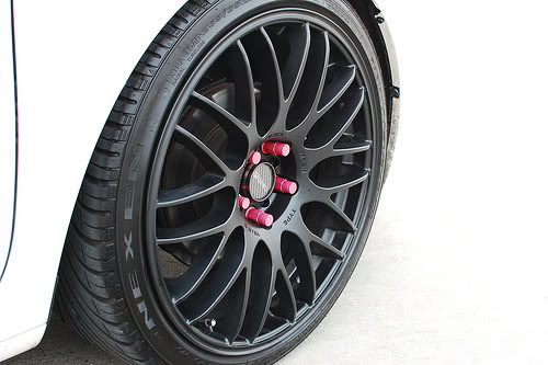

Old May 12, 2010 | 01:52 PM
1GreeKtC's Avatar
Posts: 8,460
From: 516
Extended...couldn't be happier.
Old May 19, 2010 | 07:52 PM
BLUEMEANIE's Avatar
Team Hamster
Posts: 1,372
From: THREEONEFOUR
^lookin good!
Originally Posted by danny662boy
oh ok.. ya my studs are stock length, so i would get the shorts then?
Short/regular, yes.
Tho some use extended nuts on regular studs because they like the look.
