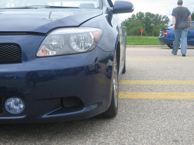

Here is what a 225/45 looks like on our rim. There isnt any bulge:
225's wont bulge at all. They fit perfect. And you will have more rubber on the road and more traction in most conditions. In snow you typically dont want to go too wide, but in most other situations you are better off with wider tires.
