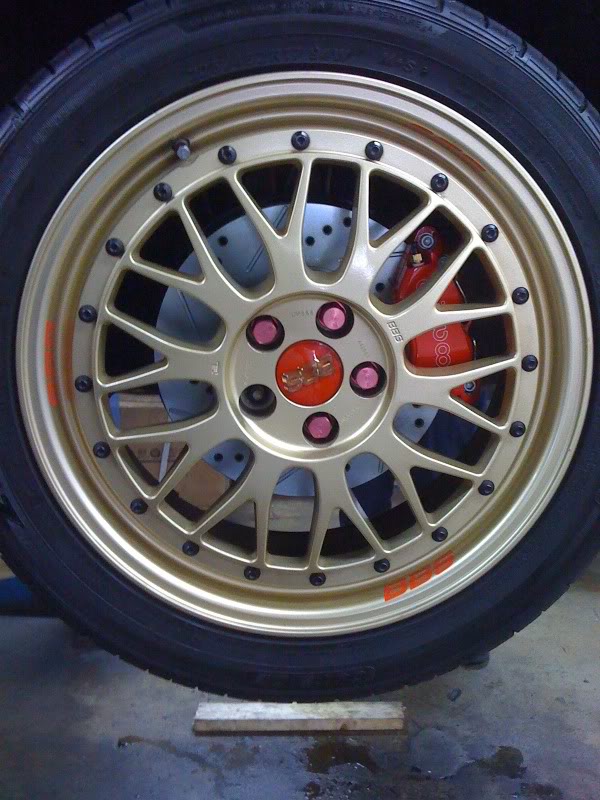

something like this, I have to remove the brake assembly and hammer a new stud on?

for the rear i took off the rotor and used a sledge hammer to tap out the studs.

Use a tq wrench every time when you tighten them and this is much less likely to happen ;)
Knock the old stud out, buy a replacement and a new lug nut.

take the rotor off dont need a sledge hammer just use a rag hammed hit the stud it will shoot out the back side of the hub ull ned a air compressor to put the new stud in

+1 What he said, its very easy. Also another tip you need to put a lot of washer or and a nut. Because you have to drive in the new stud into the hub before you put the wheel on
