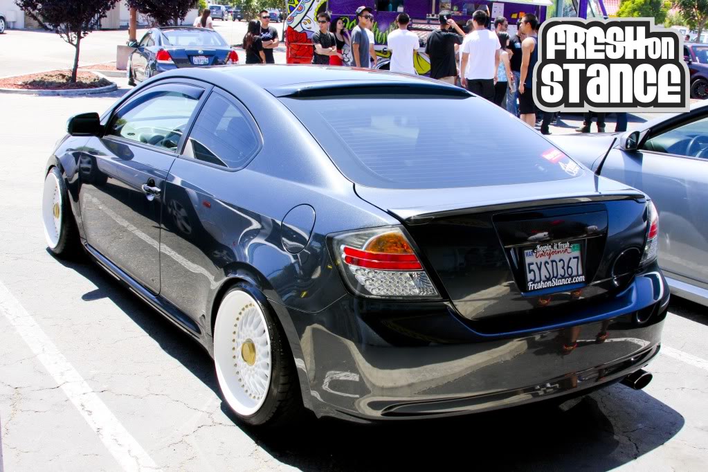

nice bro looking good...

i think "bro" is actually a chick. o.O lol

Lol.... Yeah... I'm a chick lol

^ well nice work chick! lol

congrats Glor, read the feature this morning!

"itmoves" i like that lol

lol, yeah i can't believe it wasn't already taken

Congrats on the feature, btw. I wish Mark sold me those wheels instead of you.
