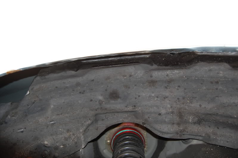

some interesting pics for anyone interested
these are shots of my front left fender well, ghetto rolled and slightly pulled, front bumper/fender tab completely shaved and zip tied!

rather then take out my fender liners, over the coarse of a week or so, i slowly chopped piece by piece until the rubbing on dips and bumps went away, this is what i cut out, these were low tire/liner clearance zones for anyone looking where the rubbing is coming from

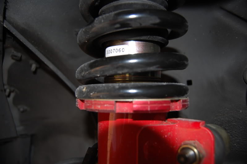

riding on one perch, but with the F&Fs the lower mount acctually locks the perch in place, i can still go about an inch lower as you can see by the threads left

I just hammered that piece up in the front and cut about that much off as well.

dang chico looks like jaws got hungry and swam under your car for a while lol

Hey does taking one ring off the coil affect the shocks in any bad way? I just started cuting the plastic piece under the spring. It sits alot stiffer and doesnt bounce now.

are you talking about the perches? if so, then yes and no, perches should only be removed if you still have some way of locking the springs perch in place, and no, it shouldnt affect anything

i have 1/3 rings in the rear, like chico said, you just need to make sure there is some way to lock it still.
its hard to say, because every company uses diff. designs
