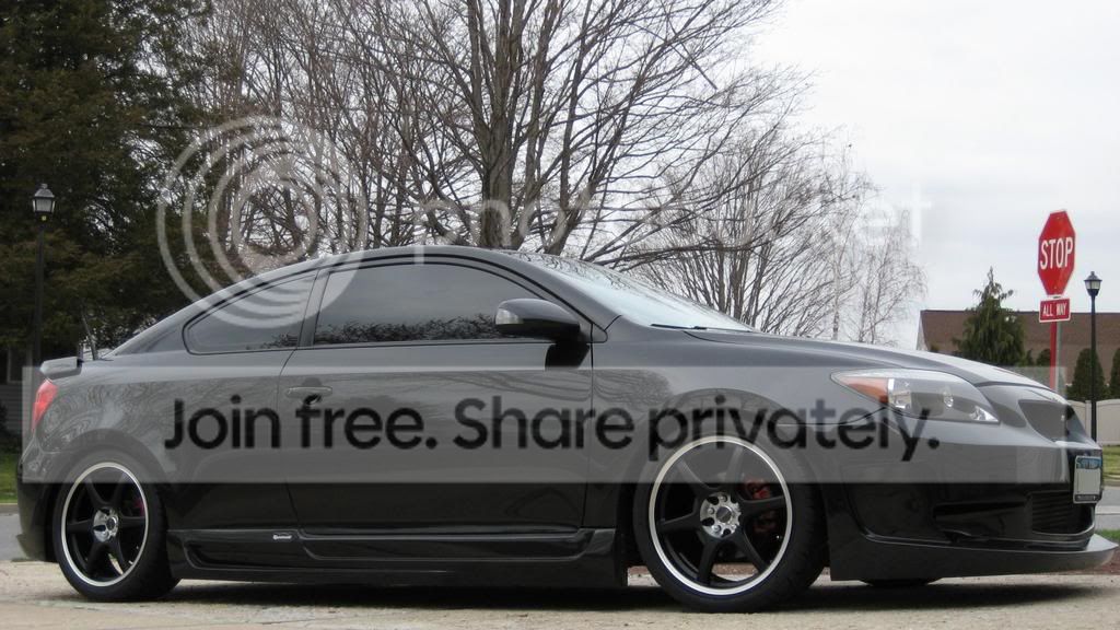

My current set up with issue is the 18x8 ET45 DC6 V2 Tenzo's that Higgy's sporting but wrapped in 245/35R18 on a year old Hotchkis drop ( I swear these bastards have settled past 1.7F/1.9R ).
EdNog over at ystc is real knowledgable on the subject. here's link with a very useful tire size fitment chart on the first page of the thread.
http://www.yoursciontc.com/forums/in...howtopic=15091
To recap:
If you'd like to run an 18x8.5 make sure it is ET42 - ET48 , wrap them in a 225/40R18 size tire, and drop it with H-Techs, Hotckis, TRD, or anything else of similar specs and you'll be fine!
current set up:
Old Apr 19, 2008 | 04:02 AM
Higgy's Avatar
Posts: 679
From: Fayetteville/Ft Bragg, NC
I think somebody else on here might have the same wheels on another BSP. I like them and get alot of compliments. Cars looking good.
