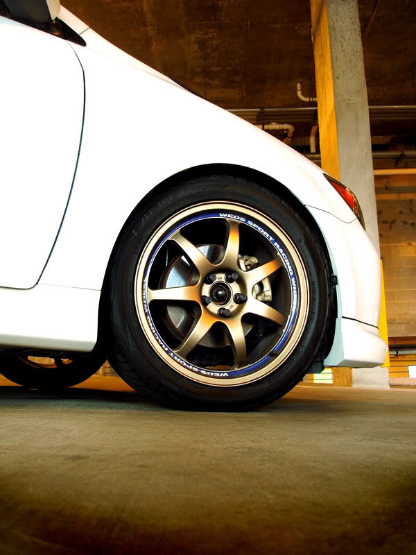

te37s dont come concave in our bolt pattern, plus the +35 would push the hub area forward to make up for the offset and face design....
http://t3hclap.com/Photos/Feature/Bi...llTE3722mm.jpg
look above.. you'll see it is semi concave but the area around the lugs is very thick and pushed forward... theres more metal there which pushes that area out on a 35mm... in his case since the offset is so high there is no cancave so less material is used and the area is not so thick (i hope u know what i mean by that lol)
his best option is yea like mentioned above... to get the larger caps

Here's a pic of Pete's car with the larger caps his talking about, notice how it covers up the ugly axle nut
and the spacers won't work, trust me you don't want to run 50mm spacers lol

volk DOES sell caps that are longer (larger) to compensate for the high offset and the axle spine that sticks out of the te37... they also sell the small version of the cap also... if he wants caps he just needs the longer larger ones..
or he can do what i did above like blizzard posted and pay only 4 bucks and it looks just as nice
