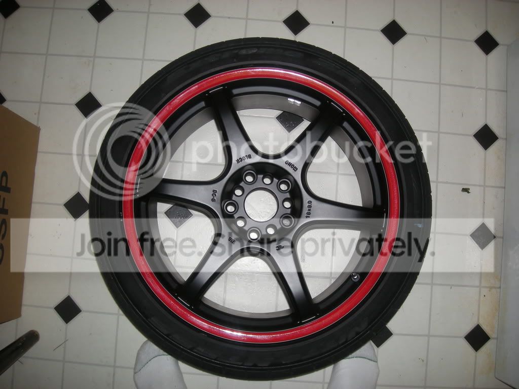

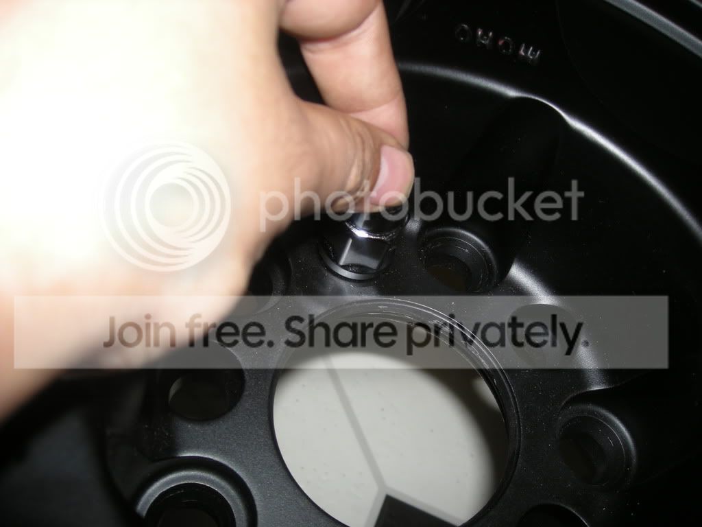

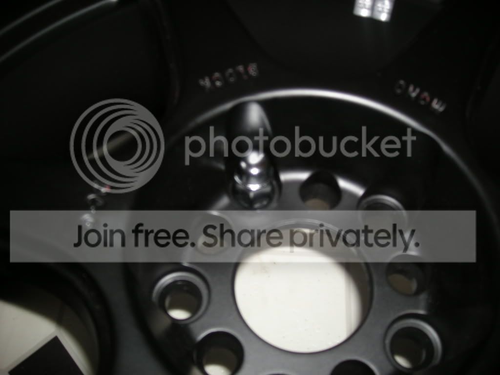

well i got my rims in today! lucky it was a sunny day today. well when i took off my old rims and putting on the other, i notice there was a problem when i was mounting it i had no problems until i started putting in the lug nuts. i put on 2 then the 3rd, 4th and 5th was really heard to put on. note this was finger tight. i didnt use a wrench . so i took it off and went inside to look what was the problem. this is what i notice. the hole for 5/114 the lugs fit totally flush. but when i put the lug on the 5/100 hole it wasnt. just left a lil crack. here is some pics.
my sexy rim
the 4/100 hole sorry i did my best to show u guys that it wasnt flushed with the rims. u cant really see the crack. but i hope u guys get the idea
this is the hole with 5/114 and it was totally flushed.

U need to use the SLIM Tuner Lugs!..it sucks too!..I wanted to get some WORK Lugs or some other cooler look'in lugs!

The set of holes you tried to put your lugs in is just for decoration. The wheels you got ARE NOT for both 5x114.3 and 5x100. The bolts go in the holes w/ the groove.
EDIT: Like how you have it in your 3rd pic

well i called them up this morning. i told them what happen and there going to send me the new lugs :D
