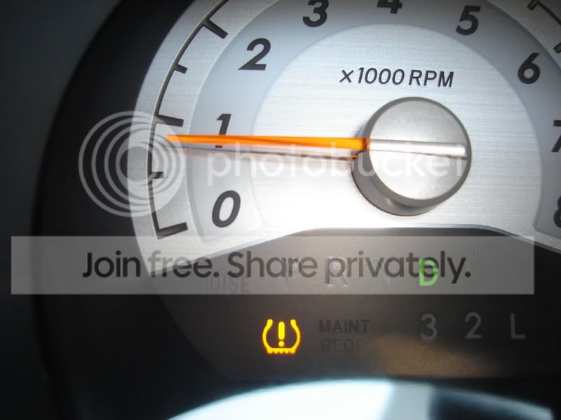

Default Fix for tire pressure warning light
OK, well i got fed up with the tire pressure warning light and I'm not ready to remount my new rims. So I've got something of a "fix". Ha. Mind you - this is Version 1.0. I made a sticker to cover it. Its just really distracting seeing that glowing light that randomly blinks, when i have my turn signal and no seat belt on (which is not often - buckle up!) it looks like a christmas tree on the dash. So Version 1.0, I printed the below faux carbon fiber sticker on photo paper and put a tiny big of spraymount adhesive on the back (allow to dry for a few minutes and the bond will be weak enough to remove or reposition but strong enough to stay in place, I would never put a real sticker on the dash glass/plastic). In Version 2.0, (lol) I will print the same or slightly modified logo on a sheet of clear window-cling decal paper that I have. I just need to readjust the image so that there is less white - as white will show as clear and then I'll see that light shining thru. I'll photo that when its done.
This is the light for those who might not have seen it.

The moral of the story - when you get aftermarket rims on your '07 tc make sure they take out the electronic sensors built into the stock valve stems and put them in your aftermarket wheels!
