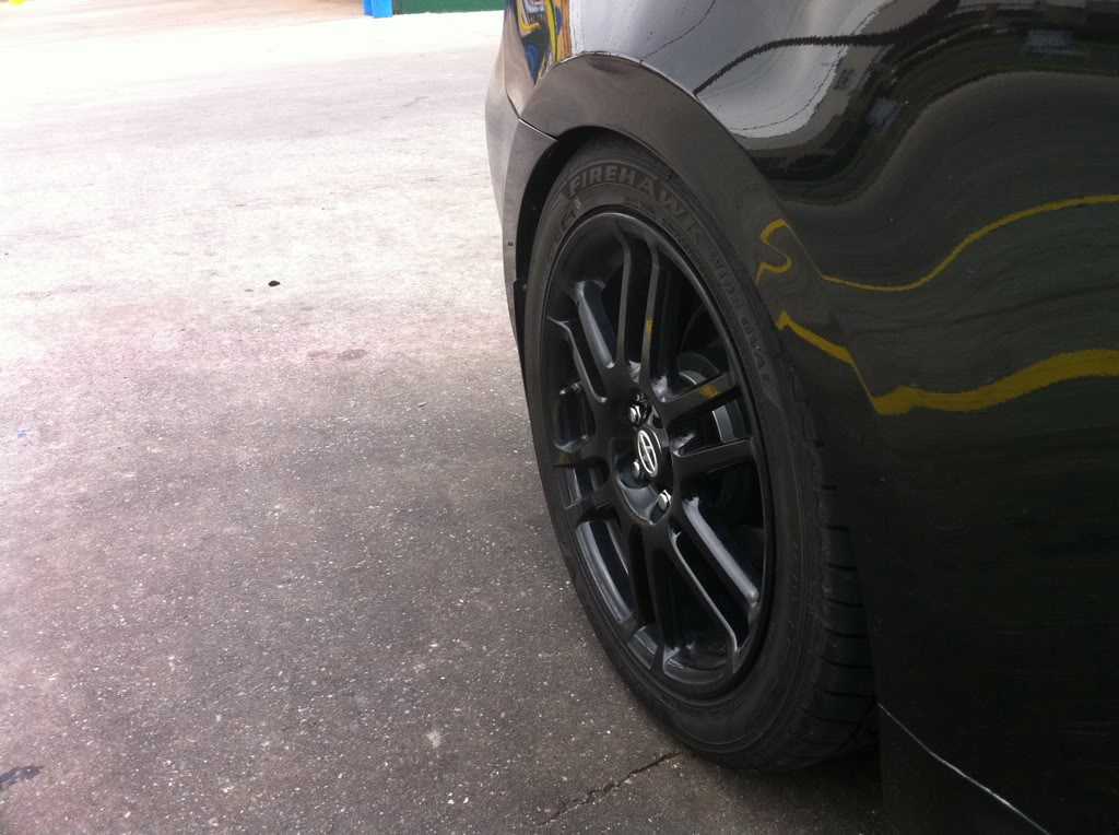

hello, my rear tires are rubbing hard where the rear bumper meets the fender. i noticed my tire actually rests on the bolt that holds the bumper. also it rubs on the tabs. i would say on a level surface, there is a 1-2mm gap between my tires at the bumper/fender tab...does anyone have a picture of what it looks like after shaving the tab off? how do you attach the bumper afterwards? or if anyone running an aggressive setup knows any other tricks, please let me know i would love to solve this problem...even -3 camber is not doing it for me... thanks!
ps: running 215/40/18 on some 18x9's... dont think that should be the problem as ive read others have done it...just need to know the secrets of how to get my car driveable again.... -___-

uhh I'm pretty sure -3 degrees would do it, since you don't even have that aggressive of a setup...this is what I did to my tabs.

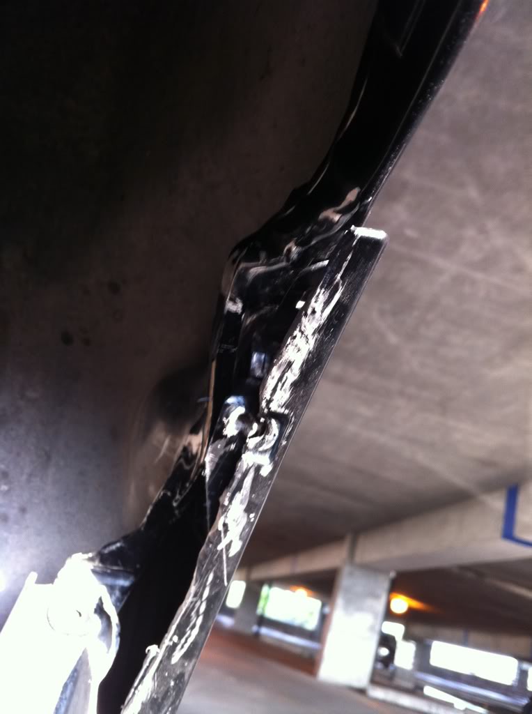

did some cutting today
I didnt cut the metal at all, I used the Eastwood roller to bend the sh*t out of it all haha
thats an in-progress pic, things cleaned up a lot nicer when I finished. I still need to add a zip tie on each side to get the bumper to fit perfect again so I'll snap some pics when I do that

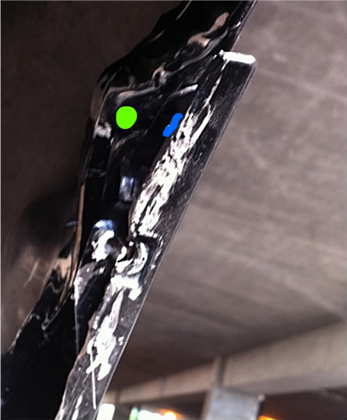

I didnt get a pic of the zip tie in place... but I drew on the pic I posted above to show what i did:
I drilled a hole in the metal where the green dot is. And the blue line is a slit in the bumper that clipped into the stock mounting points. Just ran a zip tie through those two points and it worked out pretty well:
