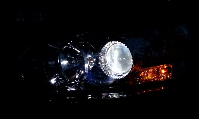

You say that like it's a bad thing! Basically it's going to make your 6000k's look less blue and more crystal white. Like this:
