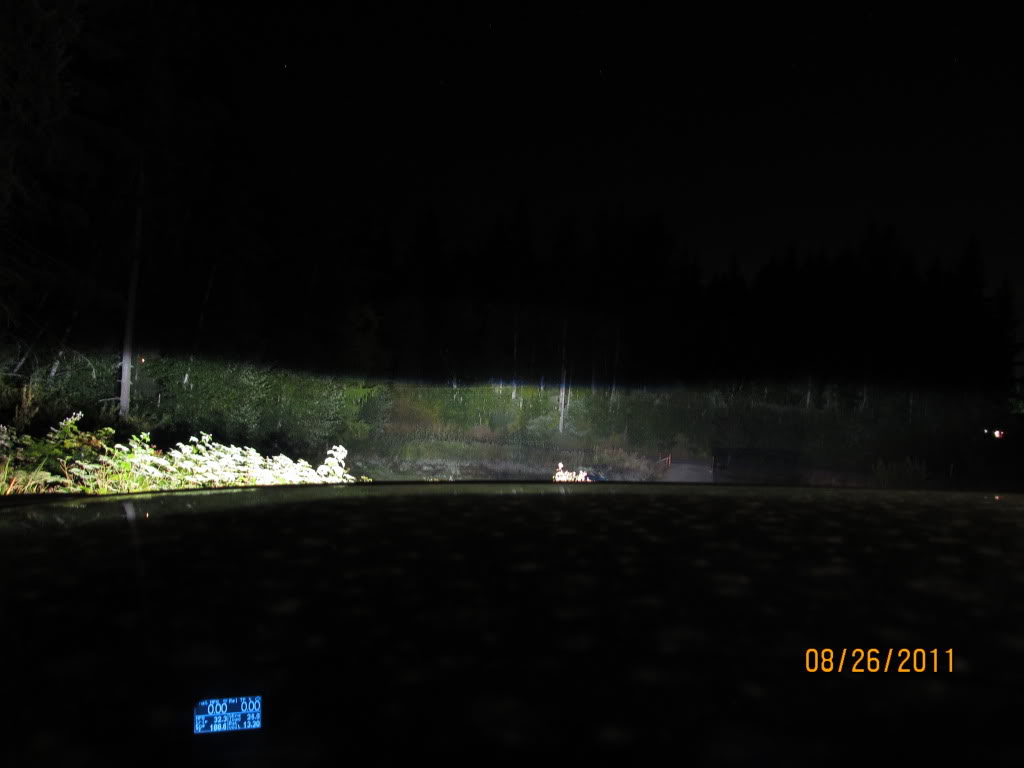

Here are the pictures of my result:
Low Beam: (the tree line is ~400 feet away)
High Beam: (notice lows are still brighter than halogen highs)

However, once you go under the cutoff point, that's where the brightness is

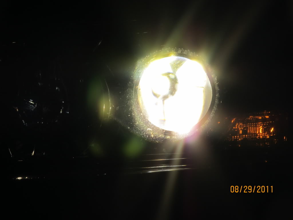

(this is a better color reproduction, and is relatively accurate)
As to how my lights are aimed, the pictures in the original post were taken from at the top of a hill overlooking a field below. No, I don't drive with my lights aimed to the top of the tree line.
The cutoff point between 35w and 50w does not change since you are using the same bulbs, so no need to adjust your projectors. Remember, the brightness is only a slight increase when changing to 50w ballasts.
I did compare my 50w 4300k HIDs in my tC side by side to my girlfriends 2008 Dodge Caliber that has SilverStar bulbs with reflectors. Her reflectors had plenty of wasted light (glare) since that's the nature of reflectors. The projector of the tC has none of that from the same angle, just a glowing orb. I'll post a picture up soon, but I can't right now since she is at work. Another thing I noticed, is the brightness would get brighter on a reflector as you got closer to the cutoff point. The tC still had no glare until... bam! ur at the cutoff point. Always make sure your car is outfitted with projectors!
So to sum it all up, as long as your projectors are not aimed at an upward angle, you should have no problems with glare no matter how bright your lights are. Any other car on the road that has reflector headlight housings will always have more glare compared to the tC because... well they are reflectors. My aim allows me to see approx. 500ft in front of me before the cutoff point on the road, so I don't get flashed.
