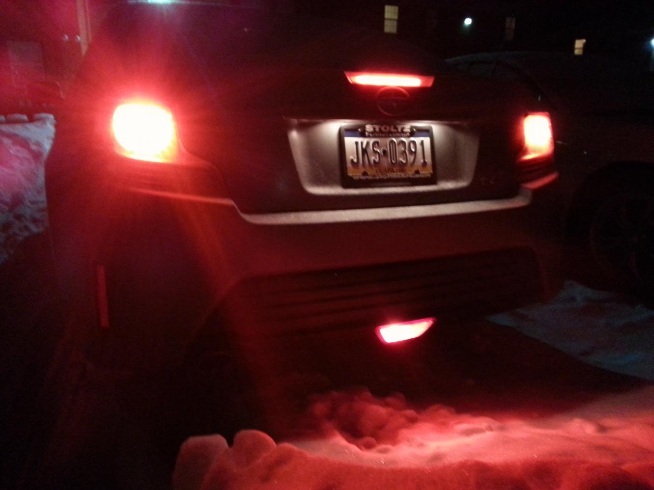

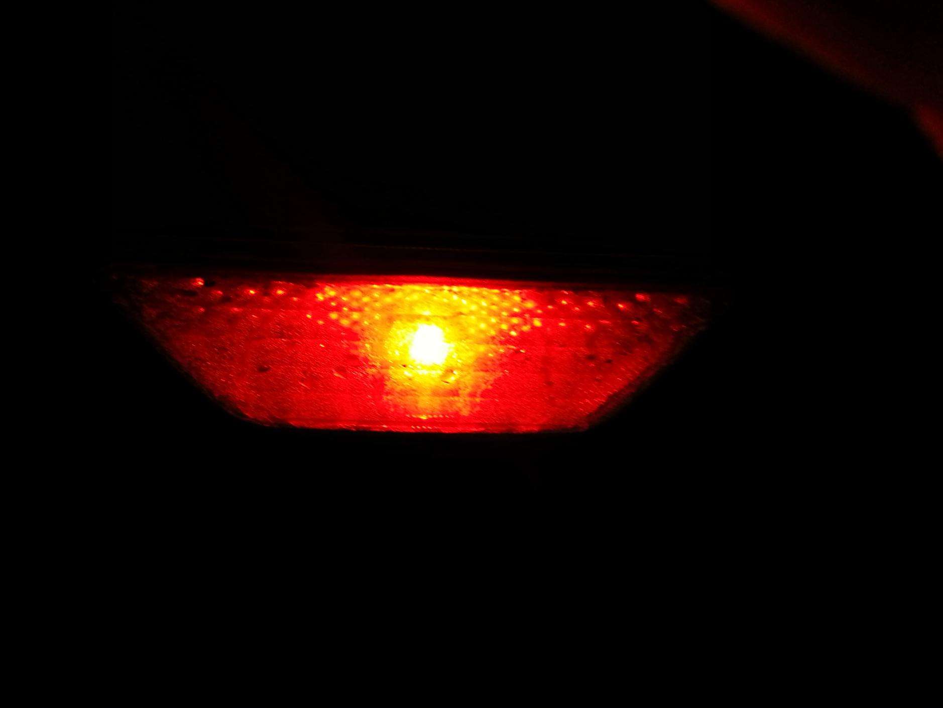

I just got my 2014 tC on Friday and Saturday night I took this light housing off, went to Autozone, got a 3157 pigtail then ground the back of the housing down and cut the hole to match and stuffed it in. Wired it to park/brake today and works great, just trying to find a shielding bulb or maybe a chrome dipped once so the filament isn't as noticeable. I think total cost for me was like $20?
Parking lights on - https://www.dropbox.com/s/ejfhgebwof...2022.10.16.jpg
Brake lights on - https://www.dropbox.com/s/8tyfibr3q1...2022.10.53.jpg
Light up close - https://www.dropbox.com/s/zftrfew1zh...2022.11.33.jpg
There is a plug in trunk that you can run wires to and tap into the harness going to passenger tail light. I am trying to remember but I believe Purple=Park, Green=Brake, Brown=Ground.
