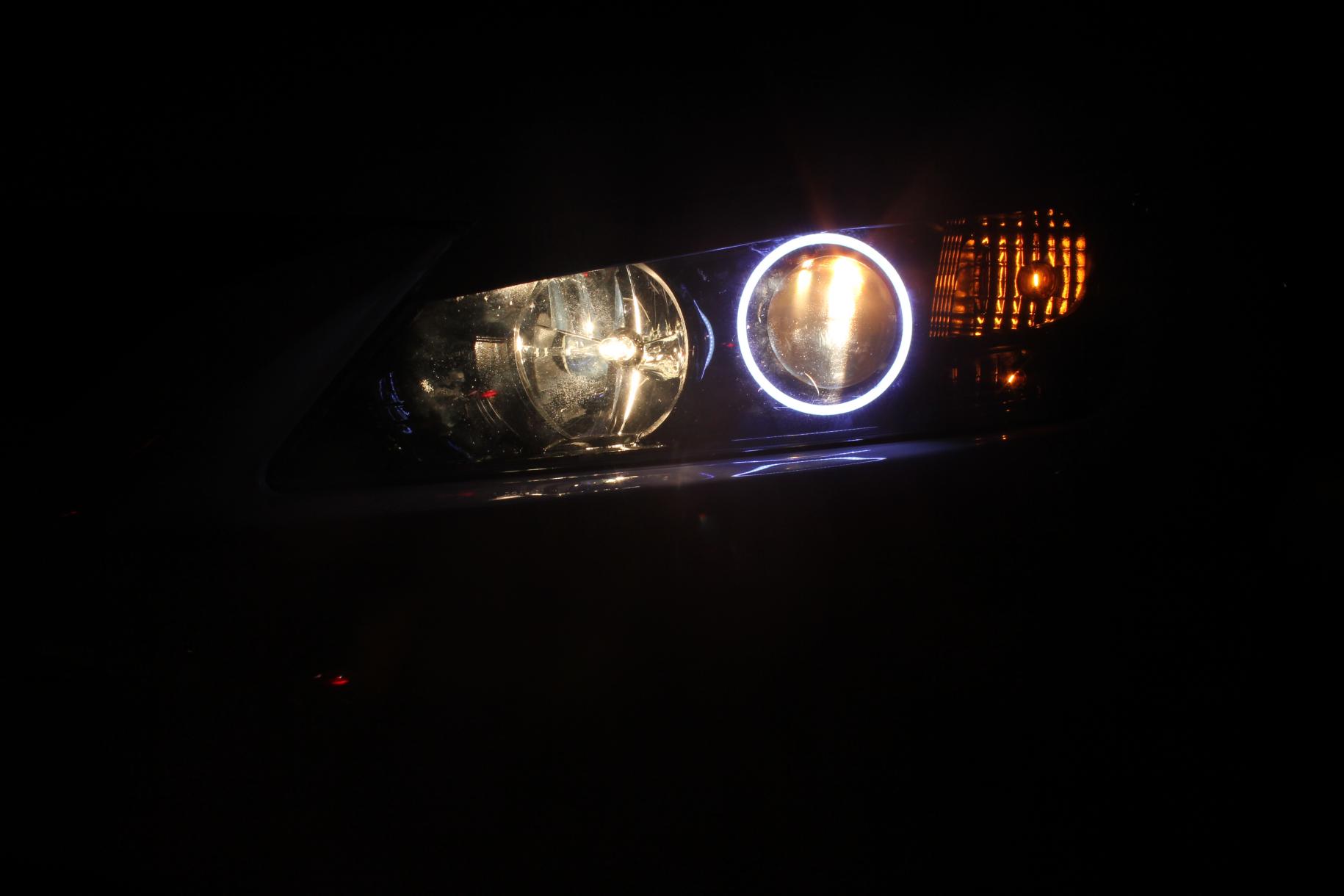

I will start off by saying that this was an easier install than i thought it was going to be. After I pulled apart the headlights, I painted the interior housings, along with the turn signal reflectors. I waited until that dried to glue on the 90mm halos with "quick seal" made by DAP. it acts like contact cement so once its on, its not coming off. the only mistake I made was trying to drill holes in the plastic interior housings, which cracked. Luckily my NIA eyelids are covering the crack so its all good. These are definitely a head turner, and though i get called a beamer wannabe at work, they get compliments everywhere. the halos are consistent, and bright. if anyone has any questions, feel free to post a reply.
