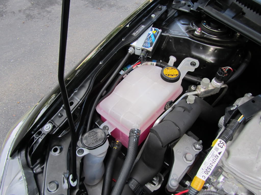

my setup:

Originally Posted by Scion202
my setup:
Lol you can barely tell they are in there nice setup
