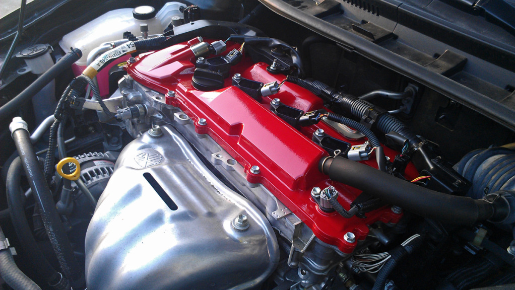

Q about this. if wanted to paint, what paint should be use?
Old Apr 17, 2012 | 01:24 PM
TankedPilot's Avatar
Joined: Dec 2010
Posts: 145
From: Sunshine State!
I used the Ceramic brake caliper paint and baked it in the oven @ 250 degrees for an hour. You could use any heat resistant paint.

Old Apr 17, 2012 | 01:30 PM
biglilsteve's Avatar
Joined: Nov 2010
Posts: 2,745
From: Maryland
That's gorgeous. I'd take that over a plastic/CF engine cover any day.
