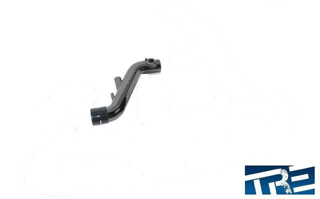

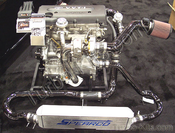

So my buddy has a 2011 Scion tC and he want's to go turbo. My question is has any one tried taking a 2010 Turbonetics kit and used it on a 2011? I think the manifolds? I'm hoping the MAP sensor flange is the same as well. I think I can doctor up the IC piping to fit. Then ill do a custom down pipe and open dump right off the wastegate aslo a custom 3" S-pipe back to 2.5 exhaust.
Turbonetics kit

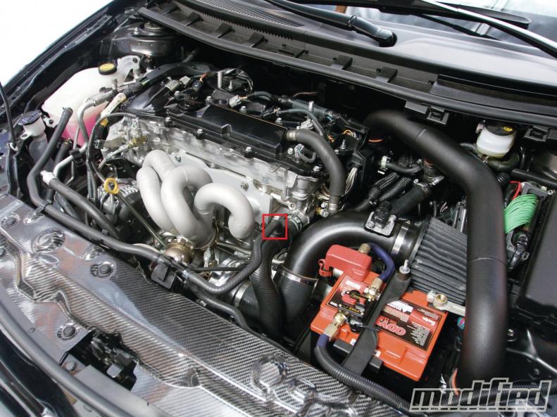

First concern the Slave line might need to bend or get a fitting
Custom Turbo kit???-009.jpg Ptunning kit
Second concern
Custom Turbo kit???-overall.jpg The electrical in the way of the intake
Custom Turbo kit???-intake.jpg The intake will need shortened looks like 8in
Old Nov 24, 2012 | 09:30 AM
motoxxx87's Avatar
iTrader: (5)
Joined: Jul 2011
Posts: 280
From: Seattle, WA
Third and finial hopefully concern
Custom Turbo kit???-water.jpg Water return hose might be in the way
