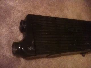

Hey guys whats up? im putting together my turbo kit and i just have a question on my intercooler core there r 2 on each side of course for the intercooler pipes, but in the left side there is another whole im not sure what is for ? do i leave it like that do i have to cover it ? help pls

Top "hole" is a flange for a HKS bov....u can have it patched or u can mount your bov there your choice.

Yeah that's what I was thinking it was I just wanted to make sure...so how can I have it patched? I kinda want the bov on the pipes.. Thanks man for the help
