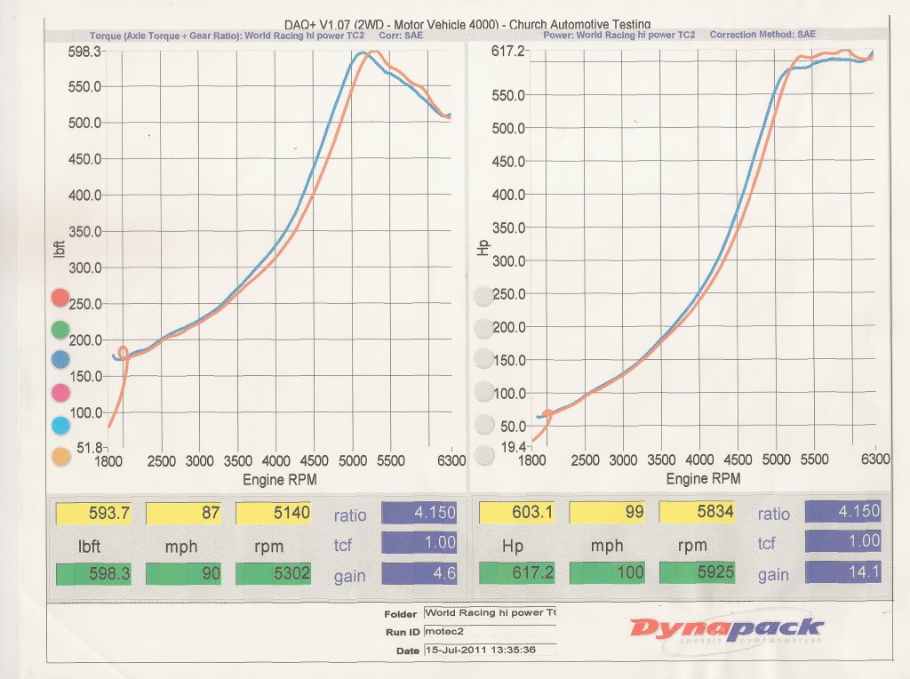

We just finished our first 2AR R&D motor for our race car. We put the motor into our street car for dyno. It's a stock head that can't be revved passed 6500rpm with rod and pistons. Has a Turbonetics Hp64 designed for m1 (alcohol fuel).We run the test with C16 on the street car @ 25-26lbs. Here is the dyno sheet.
We will have more info on the motor in the next week. A full build up.

I'm not trying to throw sand but u guys always post some crazy number but we never see any videos. I know u guys can afford a video camera it would be nice to see it few pulls instead of a sheet anyone can post a dyno sheet claiming power. Again I'm not throwing sand just being straight up.

Here is a new video of the race car on the dyno.
