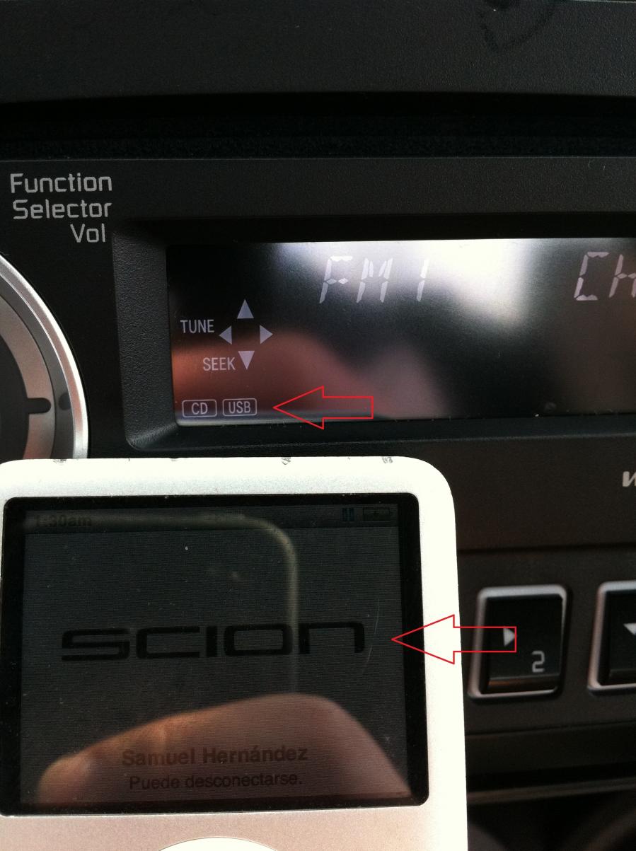

So far I love everything about this car. It's fun, looks great, and rides nice. I just seem to have 2 little problems with it. First one is that I hate second gear. Every gear feels and shift into beautifully but for me it seems that second gear is a little tough and takes quite the effort compared to the others. Second thing is the USB connector for the flash drive/iPod interface. It seems that no matter what gets plugged in, whether it's an iPod, mp3 player, or flash drive, the car doesn't seem to recognize it. Matter of fact there isn't even power going to the device from what I can tell. AUX seems to be working perfectly fine, but its a basic form of connectivity and I don't want to be looking down every time to change a song. I called scion customer support and they said that it might be a bad setup where the USB cable wasn't connected properly to the head unit, I have the base pioneer HU. After taking it back to my scion dealership and taking it apart, it seems everything is fine but they don't know how to get it to work.

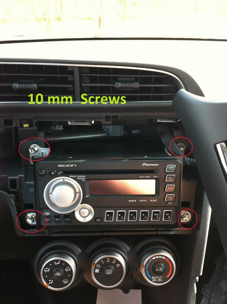

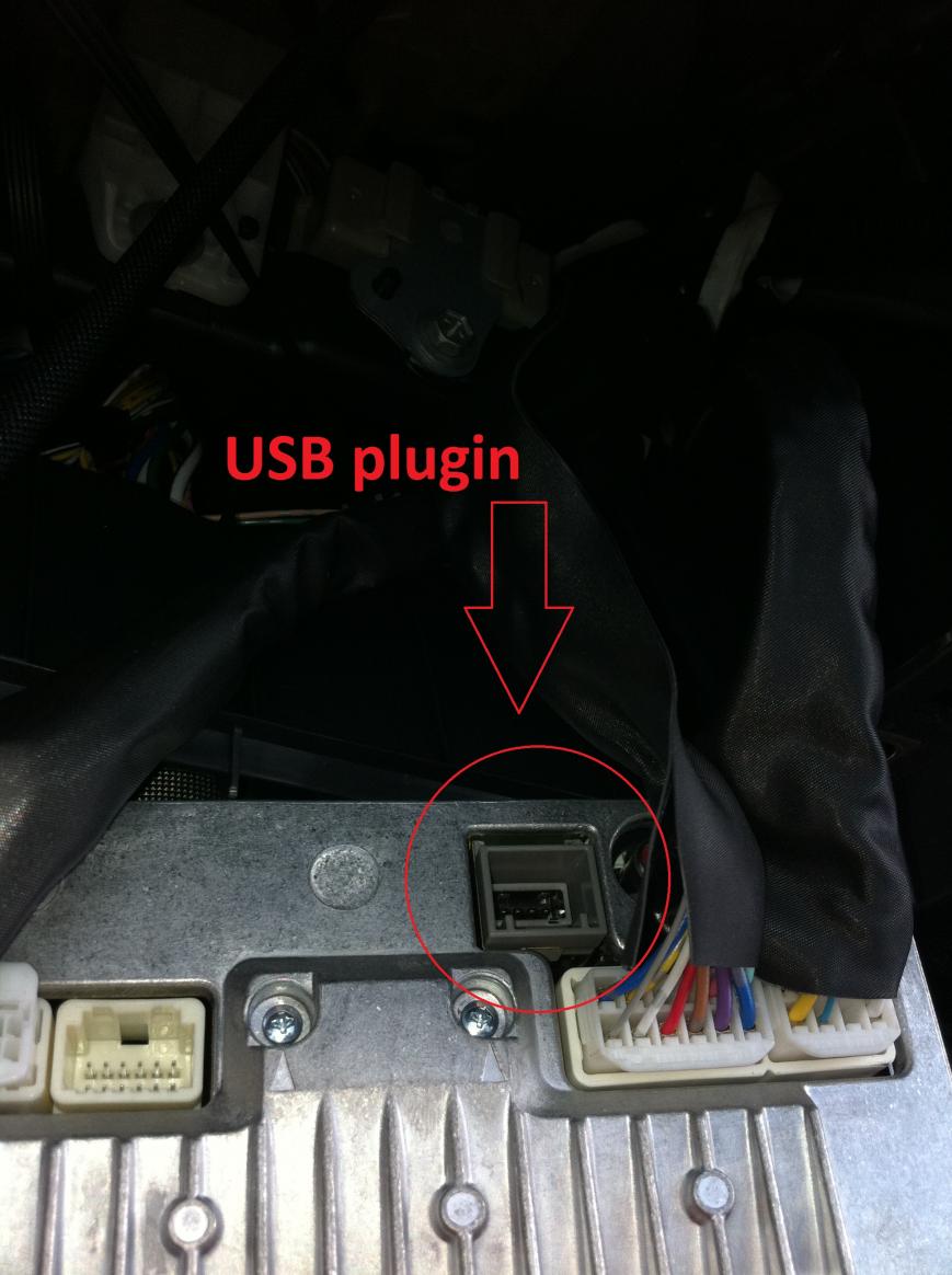

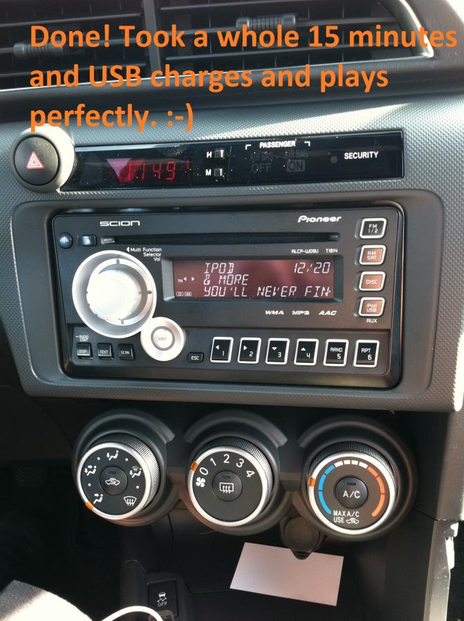

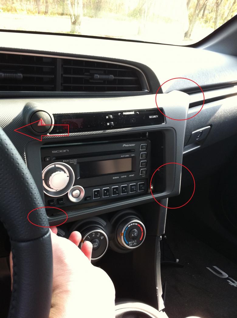

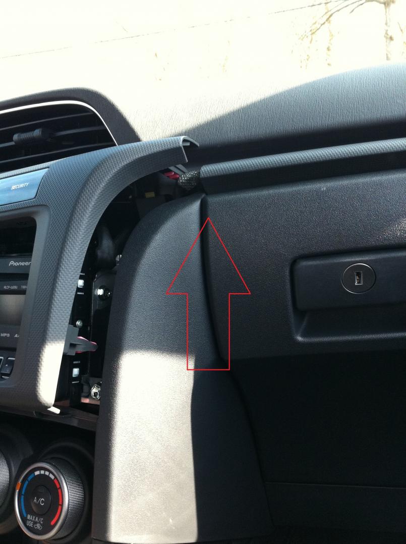

Posted a thread earlier about my USB not working at all. I want to thank 11whitetc for the suggestion and stating its a pretty easy fix and also WellesleyScion for putting up the instructions on how to do it. Quite honestly is really easy, don't know why my local Scion dealership couldn't figure it out and had to reschedule me for another day lol.
Just going to post WellesleyScion's instructions along with pics that I took while doing it, just in case anyone else has this problem and wants to see what's it involves.

1. pull the radio bezel out, its held in by clips
2. unscrew the 4 bolts in the corners of the radio
3. check that there are 4 cables plugged into the back of the radio
4. if all cables are there (4 total) pop the panel that the USB connector is located on by pulling it up
5. reach under the panel and push the USB plug out
6. check that the cables are connected
7. if you still do not find an issue make sure all of the wires are connected to the plugs of all of the connections mentioned above.

Adding that I have tried an iPod nano, iPhone 3g, iPhone 4, usb flash drive, and some old no name mp3 player I found laying around and they all worked.
