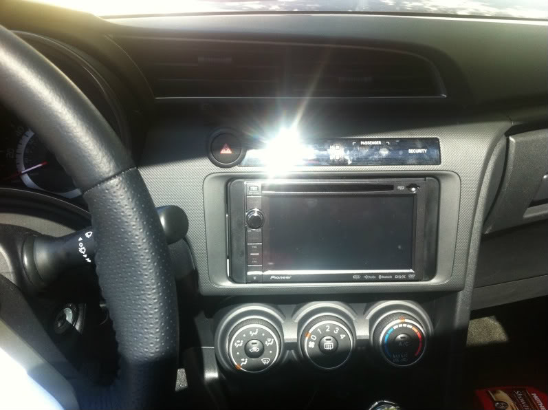

used a install kit from a xb very little modding to make it fit.499 from amazon with pioneers mail in rebate

I was to chicken to mess with the usd/aux b/c i couldn't track down where some of the black wires led to on the aux side ( 3 of them ?).
The steering wheel control i used a Toyota Steering Wheel Interface Kit for a 2011 camery plug and play work perfects too, no cutting on the factor harness.

It is possible to keep them or use the set that comes with new unit. I really like this unit its was Pandora radio built in if you have a iPhone. good nav interface also.
