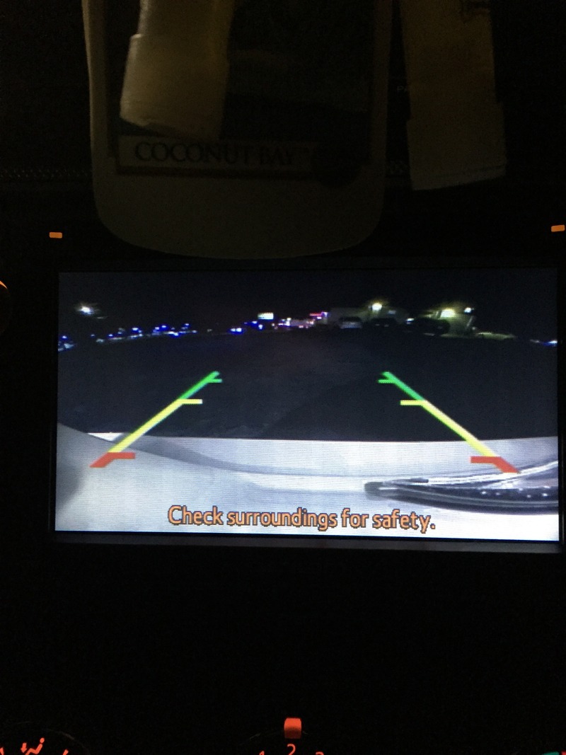

Anyways, here are the pictures and a video. I don't know how to post pictures on the forum so I uploaded them to a photobucket account and left some comments on each one. Pictures and Video
My only complaint is that the camera is useless at night. Can't see anything behind you with it. Not enough light from the tail lights to make it useful.
Let me know if you have any other questions. Happy to help.

Here are two pics of the camera at night. I guess it's not terrible if you're in a lighted parking lot. Out of driveway it's useless but I also have a dark driveway. You can be the judge!

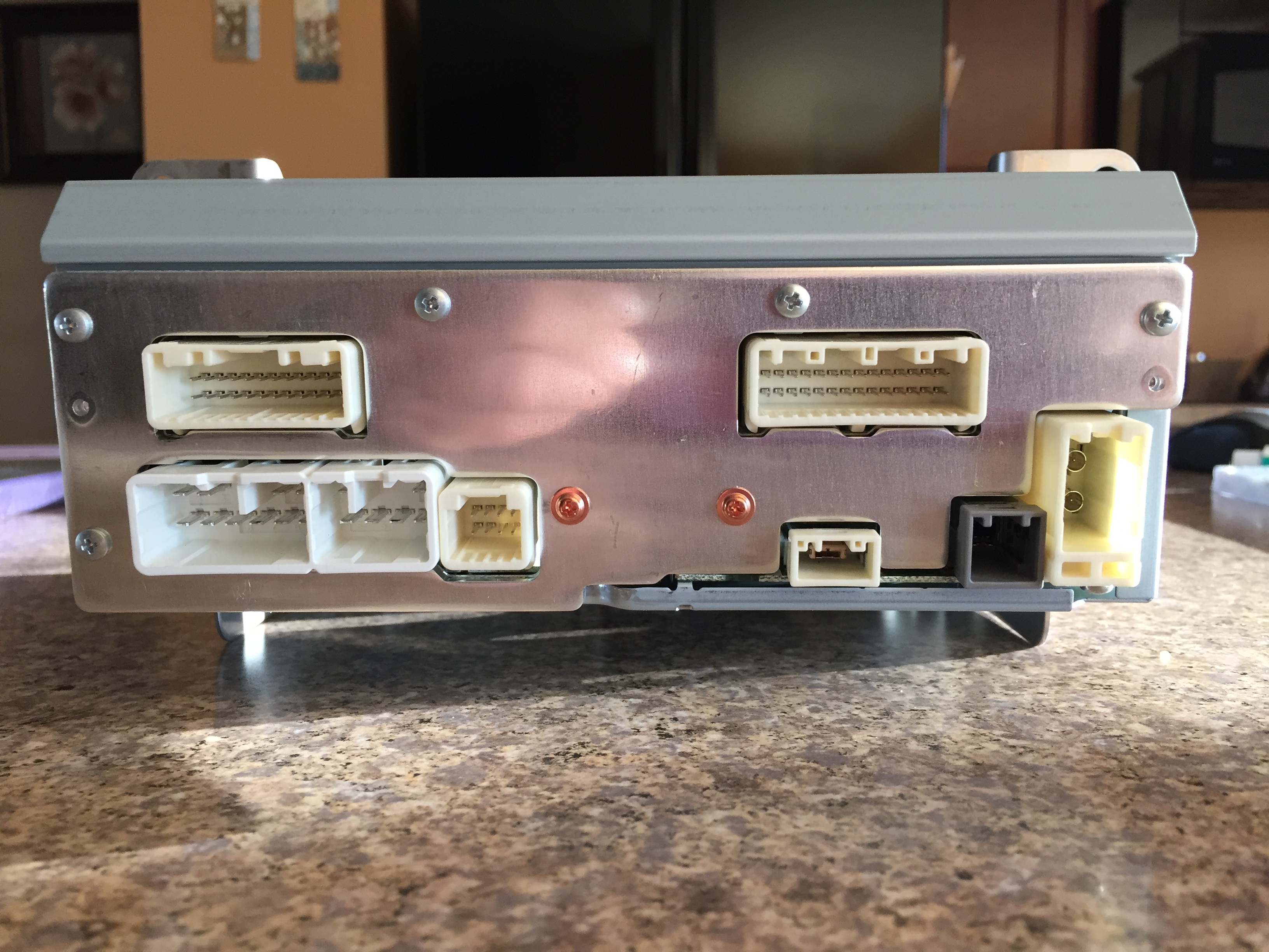

After spending some time looking into this, the 2016 radio appears to have a different connector for the video source. I have been unable to find the proper connection/harness to make this work. Here is a picture of my radio. Are you able to post close up pictures of your radio (front and back)? BTW, I see that $150 harness goes for $20 (china made) on ebay. Same connector/wires.
im glad you found this out before me.. i own a 2016 also

The 2016 FR-S has the connector we need to enable the rear camera feature. That connector is not present on our 2016 tCs. Need to get my hands on one of those, but not sure how. The dealer was not much help as they could not see the individual connectors.
