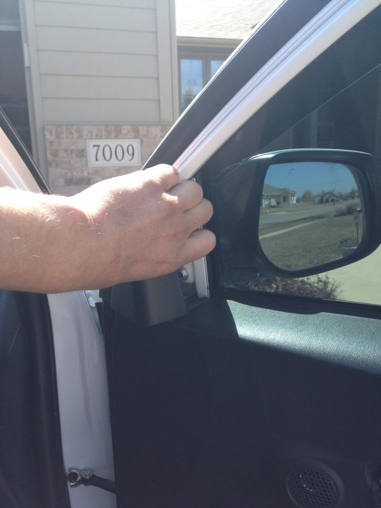

So first off is removing the door panel which is surprisingly easy!
Pop this bad boy off! I just used my hands it's not too bad. I'd suggest not scratching the plastic by using a screw driver, but it's your car do what you wish!(this applies to popping all of the trim off)

Next the side mirror cover!

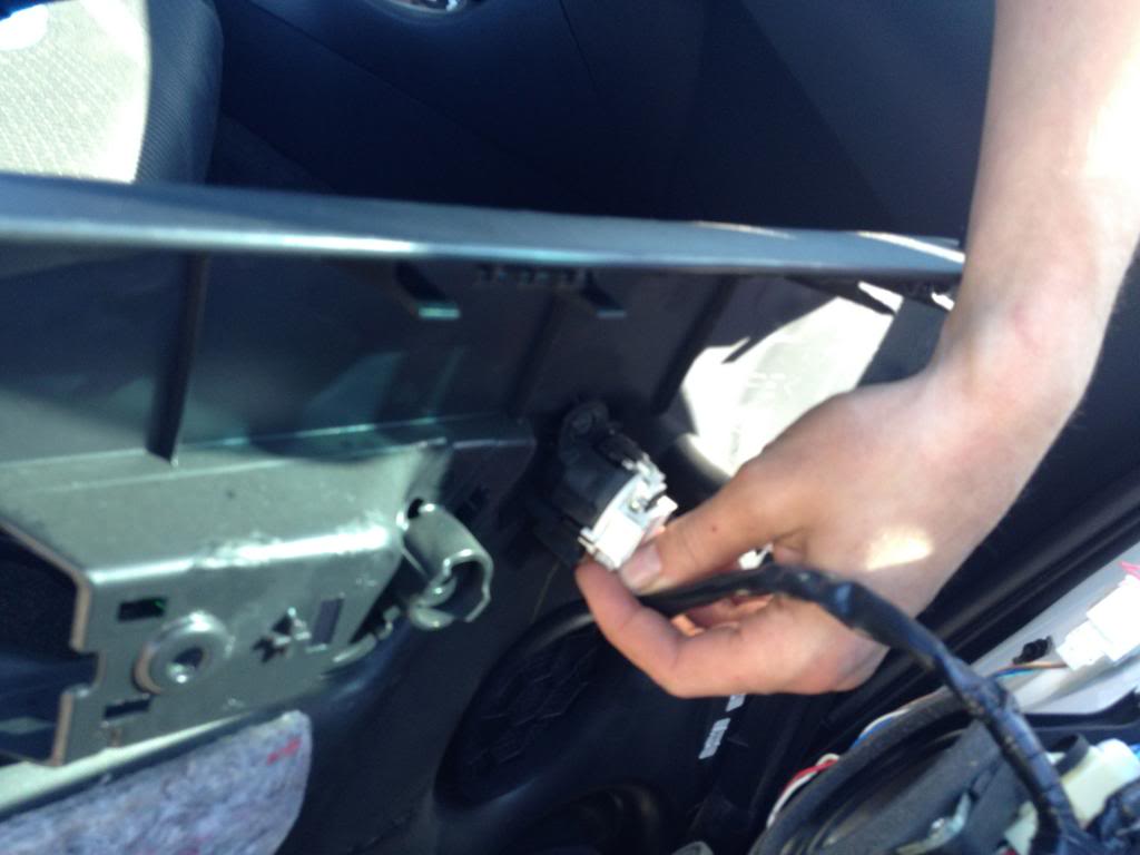

Now the controls pop out and disconnect!

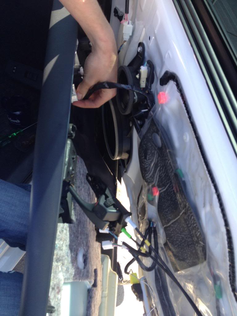

Now you can slowly pop the whole door panel away from the door! (sorry no photo for this...) Go slowly! I started in the bottom corner to the outside of the door and worked my way in, up, over, and back down. BE CAREFUL because the tweeter is connected to the door panel and has to be disconnected!
Here is the disconnect for the tweeter, also the handle will just slide out here too!

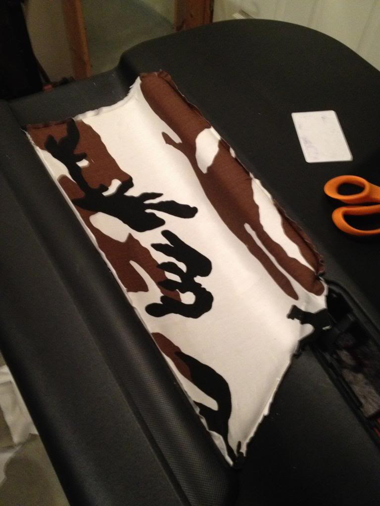

Then cut your fabric a bit bigger than the area!

Now you have to be quick with the next step! I'd practice the motions without the spray to make sure you can be quick and accurate! I say this because the spray I got gets tacky in like 15 seconds... and if you don't lay it right and miss you'll have a crazy F-ed up sticky mess... so yea I learned the hard way haha
So now that you're ready spray the exposed fabric on the door panel generously! Then quickly remove all the tape and drape the fabric over the area and use your card to spread firmly over the old fabric! I started in the center and worked out!
