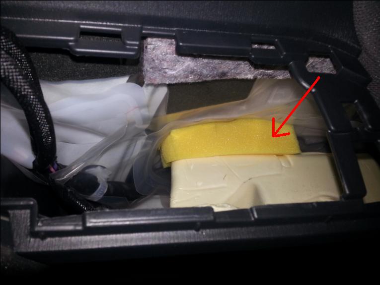

So I did the Dynamat as well, and it works a lot better than the foam for the panel. However, I found something else that's causing a significant amount of "rattling" that isn't actually from hard plastic-on-plastic contact.
The thin sheets of plastic that line the inside door are also vibrating with deep bass. I tried something that helps a bit, but doesn't completely eliminate it.
You can see the plastic in the picture with yellow arrows. The plastic goes almost all the way across the door and it's not really attached to anything, so it can vibrate quite a bit. I took a piece of sponge and wedged it in between the plastic wrap and the foam block (red arrow), and it seemed to help dampen the vibrations a bit.
I think if you want to do any more extensive rattle-dampening you'll have to take apart the door and dynamat the entire thing... but hopefully this is good enough for moderate bass.
