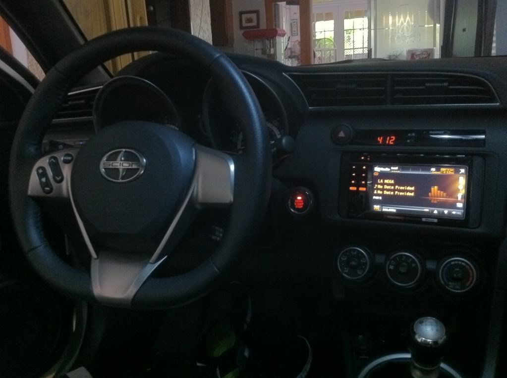

got my avh-p3300bt installed, would've preferred 4200 but didn't want to spend so much and got mine for 450 with 2yrs of product replacement warranty on best buy.
the thing is, I bought the axxess aswc kit but I did not want to splice any cables on the stock wiring, also, couldn't find how to, the cables are not the same color and there's no diagram on how to. How did you manage to do it? Is there any harness for it, I've seen them for other toyotas. Any help will be appreciated. Thanks
BTW yours looks awesome..

Here it is...

where did u come across one with a push button start, i work at a dealer and have looked but cant find the part..
Old Jul 11, 2011 | 03:47 AM
javithekid069's Avatar
Joined: Jun 2011
Posts: 113
From: San Juan, PR
Zaks, i'm from puerto rico and here its a standard option, like the rear wiper and bluetooth too
Dont know why but lucky me, because the keyless entry is super awesome, i never ever take the key (beeper) out of my pocket!
