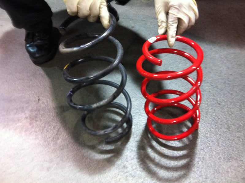

difference between stock and TRD springs.

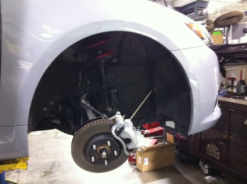

installed... thanks to a lift and power tools, it only took me an hour to get to this point...

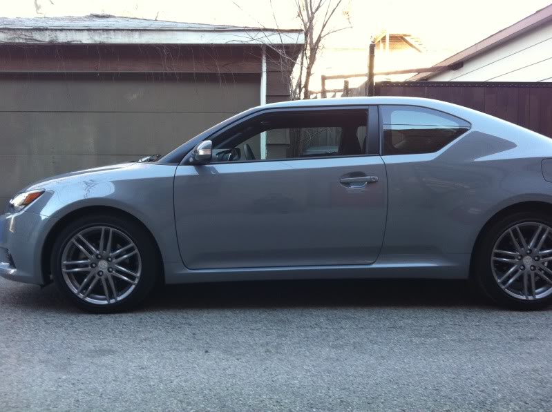

aaaannnnddddd..... done!!!

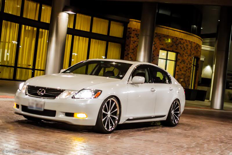

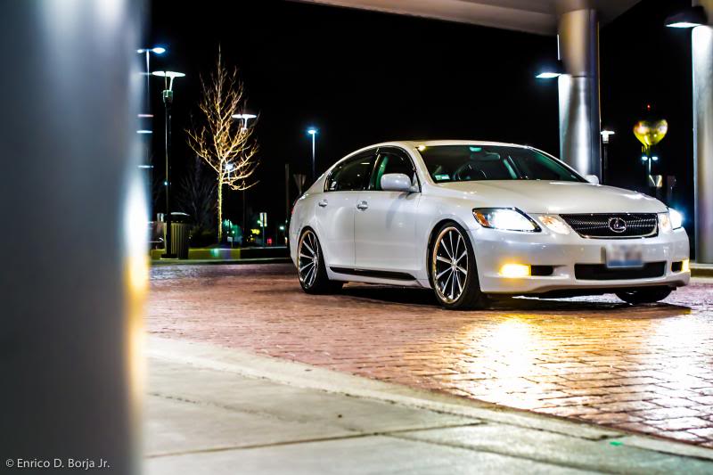

Whats up everyone??? i thought id chime in here. i kinda miss the scion forums. well, first off, i dont have the tC anymore.... i know, whomp whomp... i really do miss it sometimes. but after years of driving a coupe, i couldnt say no to the deal i got on my next car. i got it cheap... not to mention its a RARE color combination. now, im rocking a 2006 Lexus GS300 AWD. Glacier frost mica with black interior. here's some pics.
Lowered the car with Megan Racing EZ coil overs. 19" Varrstoen wheels
