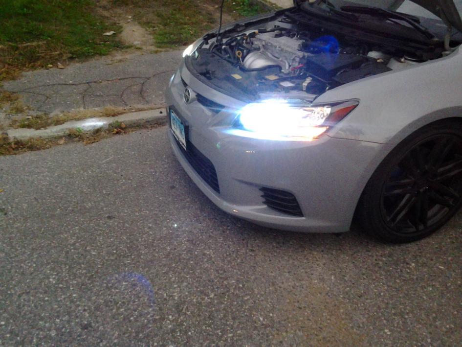

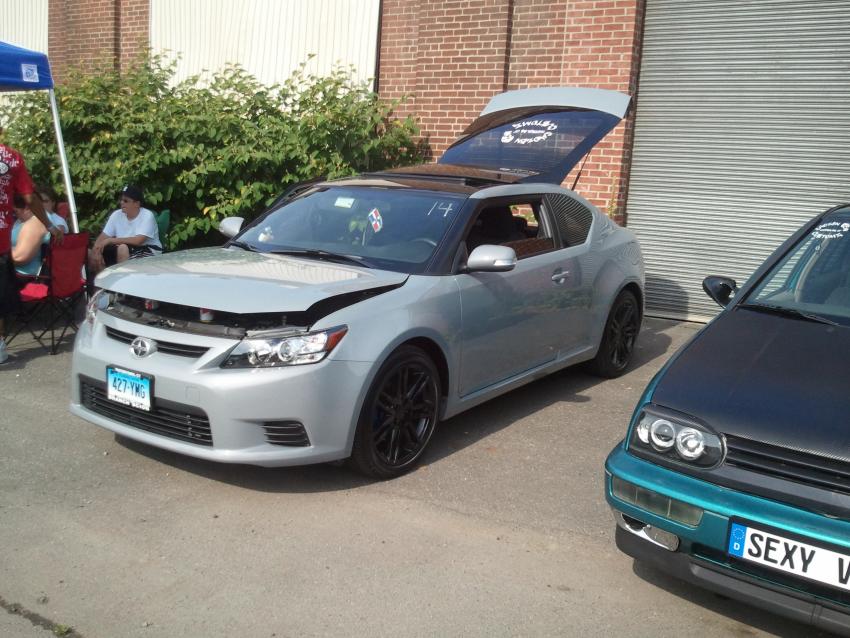

uploaded some pics of my cement( Sciomara )
when i was at a car show with jus 20 % tints all around and my stockies painted black.
also the system im working on..havnt installed the 6x9's bc the stock radio only has 1 rca output and its for a sub.. overall it sounds nice! comments appreciated thanks again.
