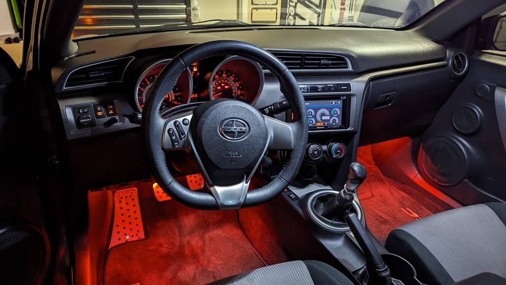

Made some more subtle interior changes that I've wanted to do for about 7 years:
Dechromed and paint-matched the HVAC control trim
Dechromed and blacked-out parking brake release button
Blacked-out glove box lock cylinder

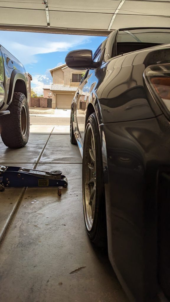

Stole one of my coworkers Enkei's NT03's to see how 9.5's fit to make sure everything clears before ordering wheels. At +40 they hit the coilovers, but with 3mm spacers they cleared everything great. Then played around with spacers to see how everything sits. They're at +32 in these pics. His tires are also too short, but the wheel fitment is great! Really liking the stretch of the 245 on the 9.5's, they're more aggressive but should rub less I do now.

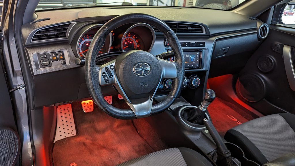

Thanks d00d! That's the OEM center console tray. P/N: PT413-21160. Really nice little trim piece.
Swapped out a slightly oxidized passenger side door handle this weekend with a fresh one from Toyota. The vids for swapping Toyota handles online don't match up for this car and the door panel needed to be removed to release an internal spring in order to the get the handle to come out/in, but was pretty simple after that. Gave me a chance to add more thermal insulation to the door as well. I love how cheap everything is for this car. I spent like $42 total on a new exterior OEM door handle + keyhole cover piece, prepainted from Toyota.
Also grabbed a fresh set of floor mats to replace my 7yo ones. Looks so much nicer in the cabin <3.

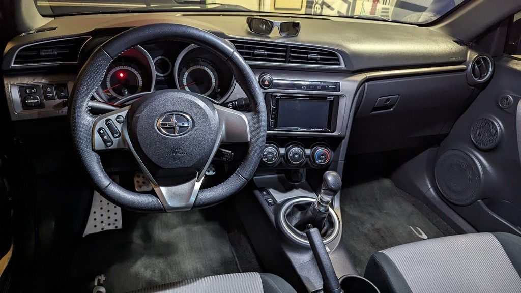

Originally Posted by drizzoh
Dirty car but clean interior shot:
Just posting whatever to keep the forum going, lol. Crazy how much of a difference new floormats, an interior dechrome, and interior dressing can make though.

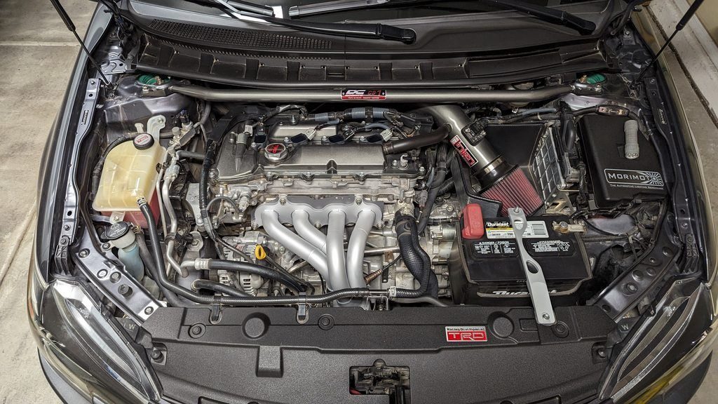

BIG UPDATE!
So first off, I got the header, s-pipe and battery tie down Cerakoted and installed last week and they look fantastic.
