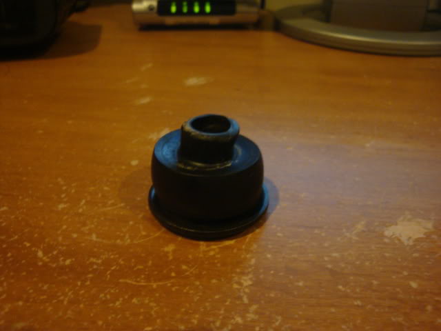

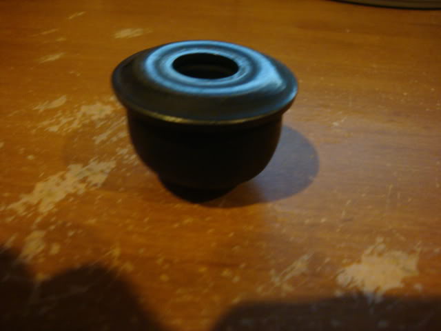

so i was adjusting the ksport coils on rear. first i did the right side, it was successful. the came the left, while gonna install back the spring, i found this on the control arm - (photo)

i couldn't figure out where it came from. so as i finish installing back everything, i measured the height from fender to floor and it was the same left and right side. i went out to test drive, it was ok. when i came back, left side is lowered than right.

I haven't looked on the car, but that looks to be a control arm bushing. Did you check or compare the left and right control arms to see if one is missing a bushing? Just a guess.

Yea Def looks like a bushing

looks like the top sway bar bushing that sits on the rlca

^this i just installed my eibach sportlines and had to remove them you may want to get that back on before something gets messed up

It may be the piece on the other side of the control arm

^you're right... it's on the other side of the bushing that KJ showed it...
