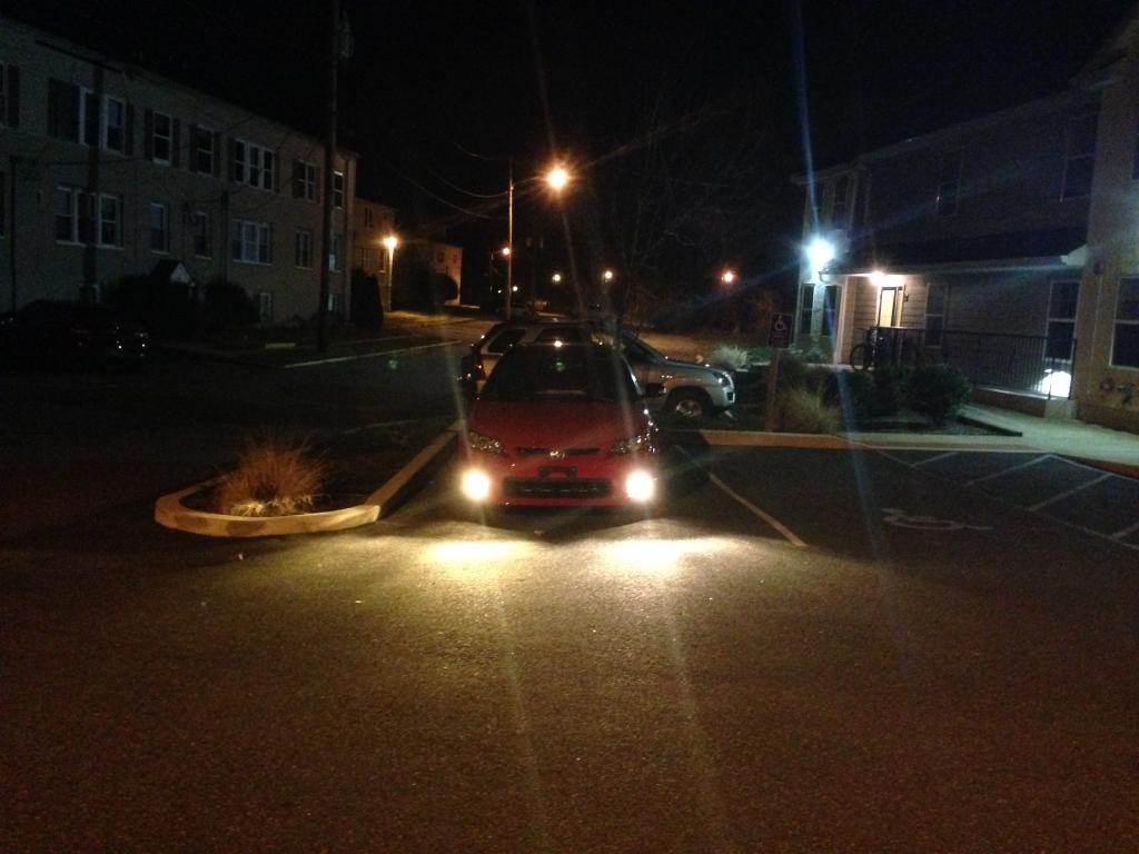

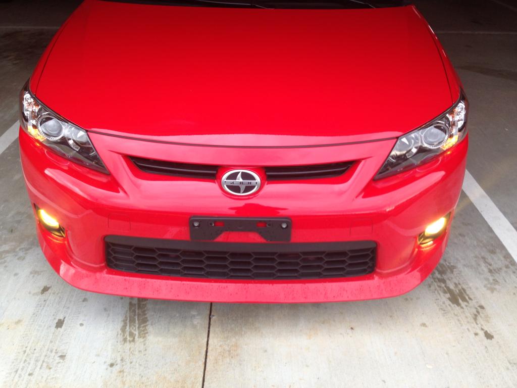

Default Update...Spyder Fogs
When I was ordering these fog lights from fastscions.com, I couldn't find anything on these boards telling me if the kit was quality or not. Everyone just says blah blah blah OEM blah so I decided to bite the bullet and give it a shot. Went for the Amber kit because the yellow light cuts through inclement weather better... at least in my experience. Kit was $129.95 shipped and came with fogs, trim pieces, front harness, interior harness, relay and switch.
Wiring was a breeze. The hardest part of the install is pulling back the wheel liner/ underbody liner. Smooth move on that one Scion. Zip tied the front harness to the body along the horn wires and grounded it to a small ground in front of the battery.
The interior section was a little bit trickier but went smoothly. The kit requires a 12V constant source which we wired directly to the battery. We also grounded this section of the wire to another engine bay ground when we ran it through the firewall. It has a fat fuse in line so I didn't see any need to wire into the fuse box. For the Ignition section of the wiring, we wired it to the Blue wire behind my head unit. This is the same wire i used to send signal to my amplifier. As soon as the key is moved to the ON position, the fogs have power. Mounted the relay behind the stereo so it can be heard turning on and off in the car. All that was left was the silly little switch and all was well! Lame green LED has to go.
Basically. This kit is for someone looking to venture outside OEM. Fitment is a 9.5/10 and wiring made it so that relays didn't have to be fooled with. I would highly recommend it to anyone!

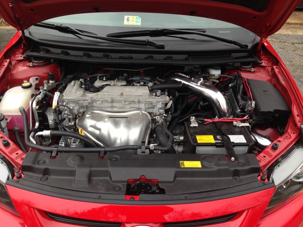

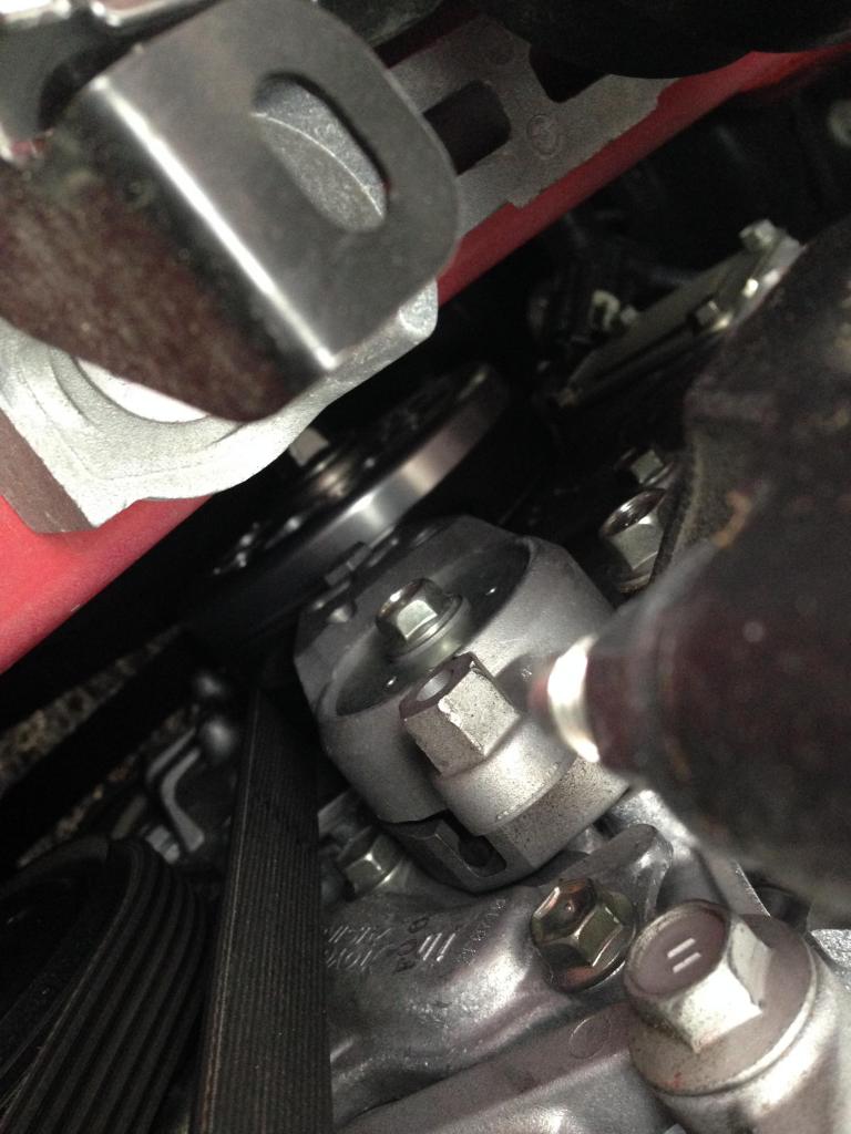

Default Update..Takeda CAI, Agency Pulley, Goodies on the way
I've had these two parts installed for a wee bit now, but I'm just getting around to getting some good pictures of them.
First, the Agency Power Lightweight Crank Pulley. Holy Moly this is hands down the best thing you can do for the car. Any amount of sluggishness associated with the vehicle is stripped away when you have one of these bad boys installed. I got my Toyota Dealership to throw it on during my service so install was a breeze! Buy one. I promise it is the best 120$ you can spend.

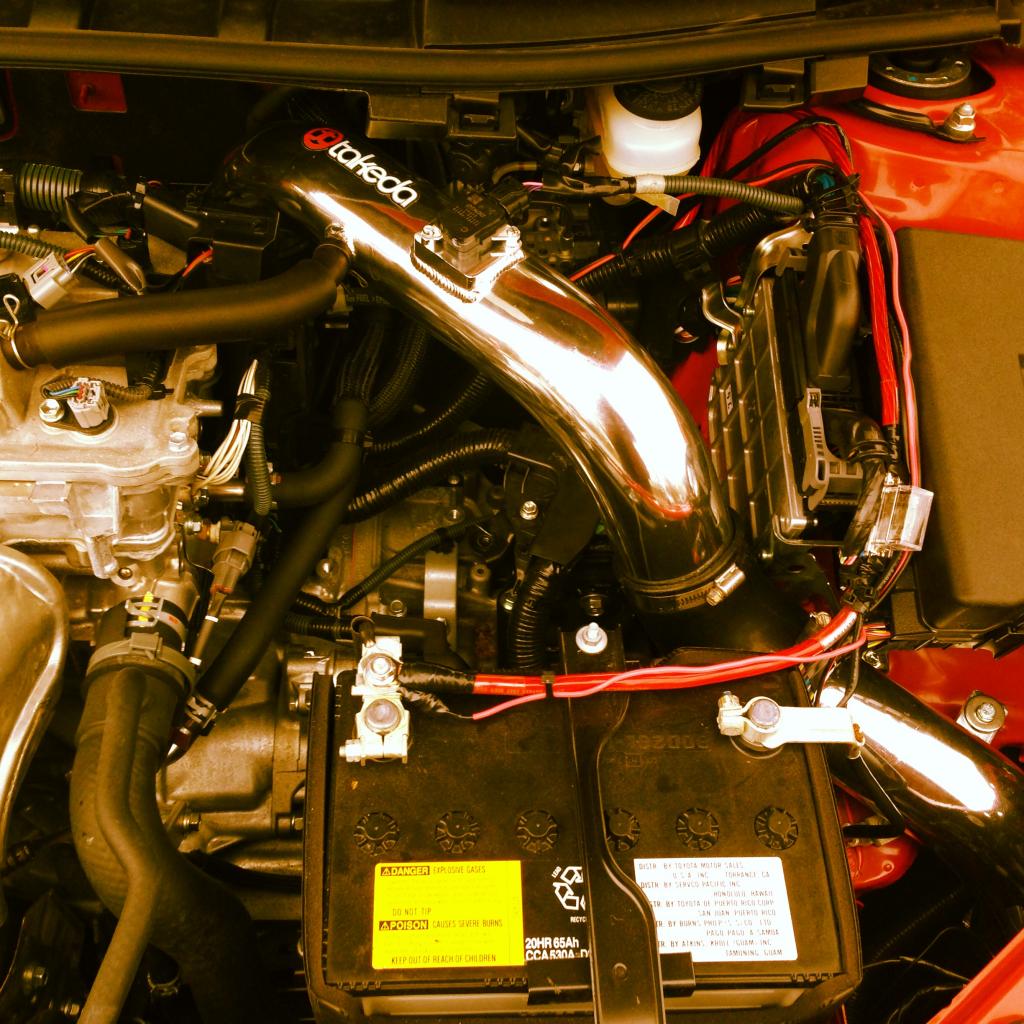

Next, the Takeda CAI. Now this is one infamous intake. Quite frankly I don't think I've ever seen more debate over a piece of tubing. I'm curious why people were getting CEL's. Maybe the MAF wasn't seating properly? Regardless, I had a CEL for about 36 hours while the car learned how to function with all that new air. Performance is definitely noticeable. A little peppier on the low end and some extra zip at WOT. Sound is nothing at normal driving speeds. WOT it adds a nice rumble under the hood that compliments the TRD exhaust nicely. Did I mention it is just super pretty under there as well?
