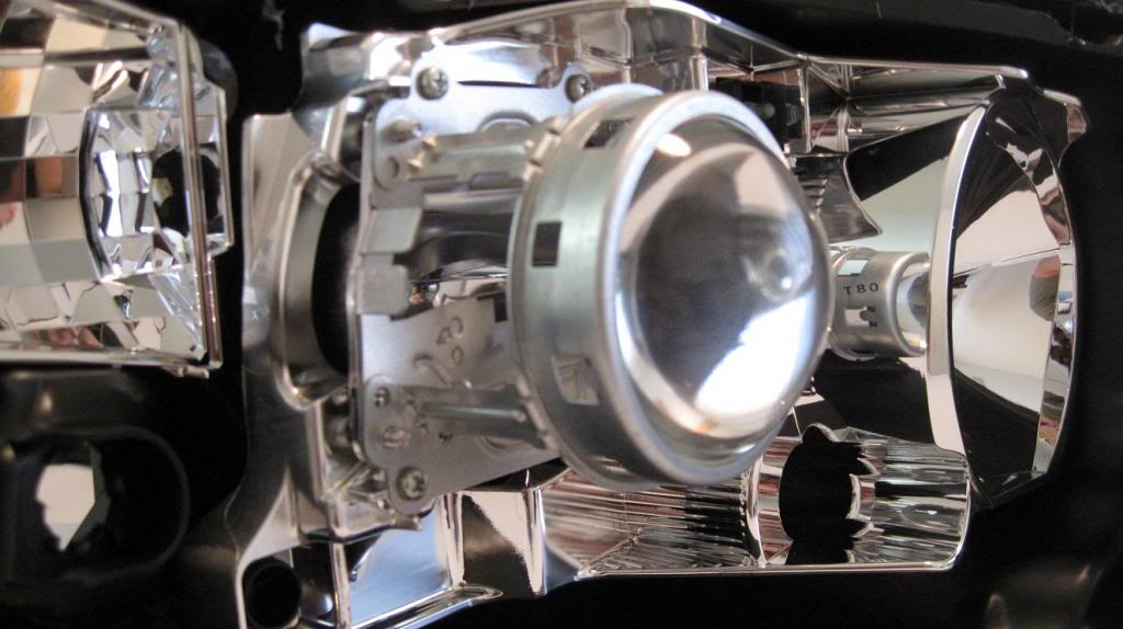

Here's a comparison of the OE projector (right) to the new RX350 bi-xenon projector (left) I'll be installing. The RX350 projector has extra bulk at the bottom of it due to the bi-xenon solenoid. You can see how it sits higher than the OE projector. I'll show how this comes into play later:
You can see that the OE projector (near) and the RX350 projector (far) have virtually identical depths.
Beware, this is very important. If you decide to do this, make sure you get the Non-AFS variant of this projector. It would take someone far braver than me to make the AFS version work with our housing. The AFS version (left) and Non-AFS version (right) don't share any of the same mounting holes!

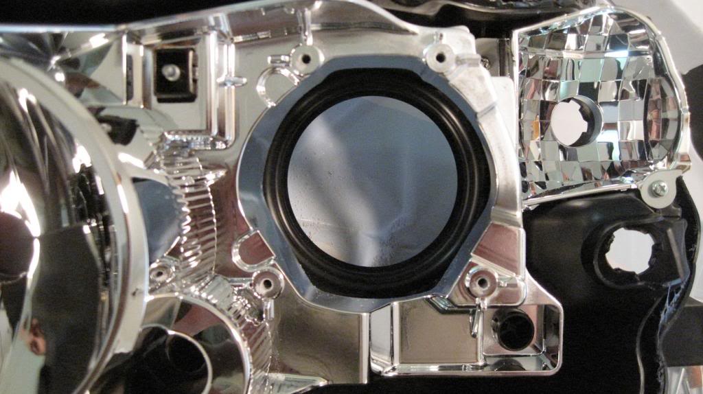

Now, you'll see what the housing looks like without a projector:

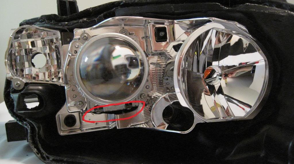

Now you see what happens when we try to just stick the new RX350 projector into the housing with no modification. There is not enough room at the bottom of this housing because the new bi-xenon projector has a solenoid at the bottom used for activating it's high beam. It's in the way and doesn't allow for the projector to bolt in:
So...Dremel time!!! The following three pictures are the before, during, and after Dremelification. You don't have to be super neat with this job because that whole piece is going to be covered by the front shroud anyway. Just be sure not to take too much out and ruin the integrity of the housing.
Yeah...it gets dusty. Nothing canned air can't solve though. You'll use a lot of it, so consider this tip: Continuous use of the canned air will make it cold and it will lose its pressure. Once that happens, take it to the sink and run hot water over it for a minute. The can will immediately be good as new. You can do this whole project with just one can easily.
Now, here's the RX350 projector in the housing. Check the circle. Now that that extra housing is out of the way, it bolts right up...like it was meant to be!!
