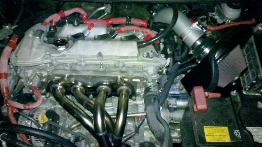

Well, all is finally installed.
and OMG its loud! No Rasp. And no second CAT either now. Shop talked me into deleting the second since it would get clogged from the lack of primary filtration plus a combo deal between the labor of fixing the lower flange exhaust leak I was left with, when I had to 'modify' the stock gasket to allow fitment on the new header. I used my dads Dremel and the work killed all available bits (4-6). Perhaps there are better bits than grinding stone ones, but these got Clapped. Barely got the d___ gasket on. Limited spring bolts prevented a full torque down to press the gasket into place. Stuck with taking it to the shop and getting different bolts, then the CAT got brought up.
Anywho, I installed all, Spec-d Tails, K&N intake, Flowmaster axelback and Dezod header. Sounds awesome, but some slight disappointment in the quality of the header. Maybe I'm too picky but there where some pitted areas of some weld area. As well a minuscule miss-alignment. Pictures and other reviews when I get time.

The pitted areas..
The better side of things..

That thing must be so loud since they talked you into removing the second cat. Honestly sounds like overkill, but if the labor wasn't expensive then it's all good.
So why did you need to modify? What happened? My V1 header fit perfectly.
I'd love to hear a sound clip man.
Old Apr 3, 2013 | 01:00 AM
TC-Maverick's Avatar
Joined: Aug 2010
Posts: 325
From: Jacksonville, FL
The only reason I caved into deleting the cat was the thought of regret that if it wasn't loud enough. I'd get ripped off for just the delete. Stupid really. Should have just waited to hear what it sounded like without a leak at the lower header flange then act accordingly. Instead, I got the BIGGEST headache trying to get them to give me the cat back. Because, I keep my stock parts and forgot to grab it before i left yesterday. Then dude gave me the biggest bs runaround flat denying to give it back. Gave me two options: pay $50 to put in a resonator or pay $60 to get the cat back uninstalled. !!!!! Livid. After collecting myself, I told one of them to get in my car and rev it. Sounded pretty good, loud but good. couldnt hear rasp, just a very poppity tone from the flowmaster. Angry at the thought of spending more money to dig out of the garbage and pleased with the sound.. I left empty handed.
Even Dezod advertises the necessity to mod the gasket. The diameter of the coupling end of the header is a few millimeters wider than the stock one. Meaning that the interior of this cone shaped gasket needed to be bored out a bit. So long as the exterior shape of the gasket is not compromised, It should fit. The majority composition of the gasket lends to relatively easy grinding and boring. However, it has a wire mesh skeleton and proved troublesome for the Dremel bits I had. Since it killed everything I had at the last micrometers of boring I was stuck convincing it to be more open to things. Possibly increasing the outer diameter by a trivial measure causing the difficulty seating.
