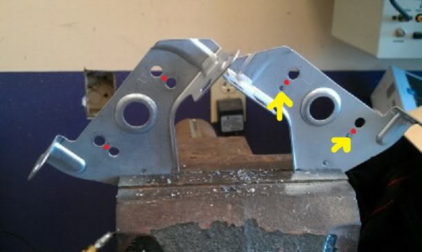

alright, so got my indash in and made my own kit because i wasnt too pleased with the one that metra had to offer. put a cpl in with fixed face screens and there were gaps on the sides and i just wasnt happy. sooo...heres my write-up and my own dash kit
alright, first things first, buy your screen! lol.
putting in aftermarket screen, you use the factory radio brackets. i had to modify the factory radio brackets to set the screen back a little further so my trim piece would clear and sit just behind the factory bezel. in the picture, the yellow arrows are pointing to the little dimples on the brackets that hold the piece in place so its screwed on right. i originally just drilled these out, as shown on bracket on the left, but when i got it in the car it put the radio too far back and i had gaps. so what i did was just took out that center part between holes, red dot area so i had a track of sorts to slide radio until i found the sweet spot, which happened to be right in the middle of the two holes for my screen

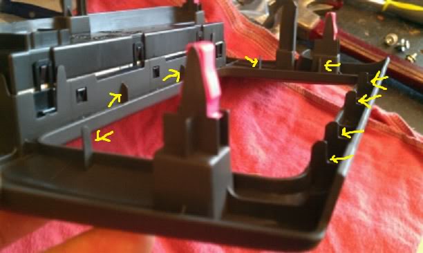

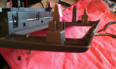

then on the factory radio bezel, i cut off the little pieces of plastic that are labeled with yellow arrows in order to give me a little play room on my trim piece cuz it sits back behind the dash. that way i had some clearence so i didnt have to cut my trim ring perfect
before
after

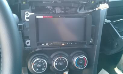

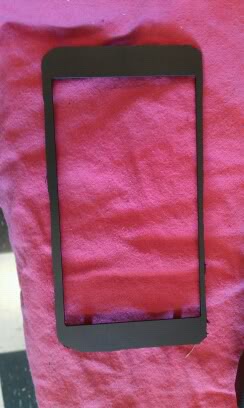

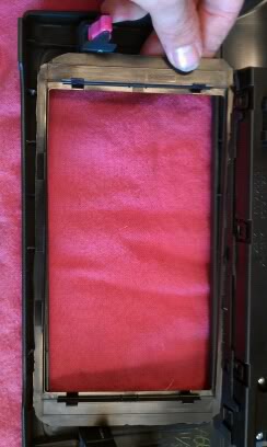

now for my trim piece, i didnt get a before shot, but it was a generic double din trim ring that was oversized and made to be trimmed down to size. i mounted the radio and put factory bezel back on to see where it sat in the dash opening so i knew how much to cut. trimmed it down as neccesary, and then double checked the clearence on the backside of the factory bezel to make sure it wasnt too big and hitting anything

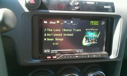

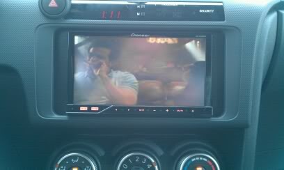

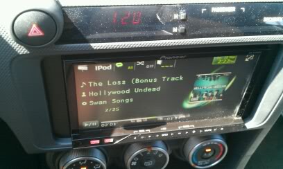

once i knew it was cut right, i clipped it around my head unit, then put the dash back together, and i had my new kit! radio sits about flush with front of dash, instead of sticking out a bit like factory radio ****, and no gaps on any of the sides. nice and clean
