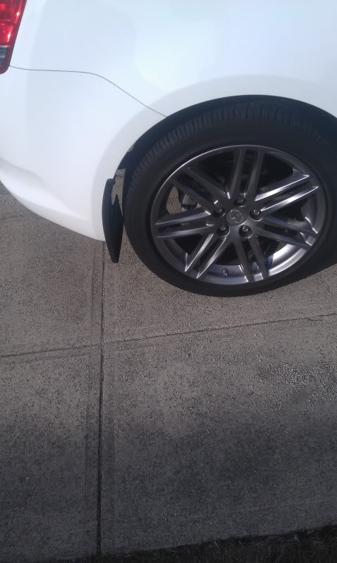

Nothing big but I added the mud guards to my car. I like that they are small all i really care about or at least am hoping for that it will help just enough with getting the bottom of my car so damn dirty when it rains

How was the install man?

The install was painless. Well as long as you either have a tool to remove push pins or ones to replace them.
In the front no drilling is required just take out 2 screws and a pin, replace those screws and then put the screw given to you with the mud flaps in.
In the back it is just as easy you will see 2 dimples where you need to drill the holes. Drill those holes on each side and pull out 1 pin. Put that pin back in and use the 2 screws given to you.
All said and done the total install took about 5-10 min. You can luckily go in at just a tiny angle to drill the holes in the back so you dont need to take the wheels off.

The mudflaps worked very well I notices much less dirty water splashed up on the bottom of my car. Very much worth the money and they are small enough not to look stupid either

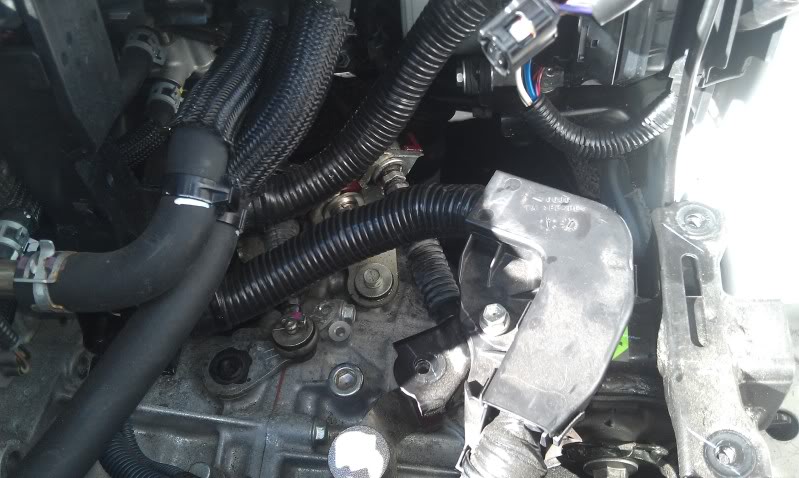

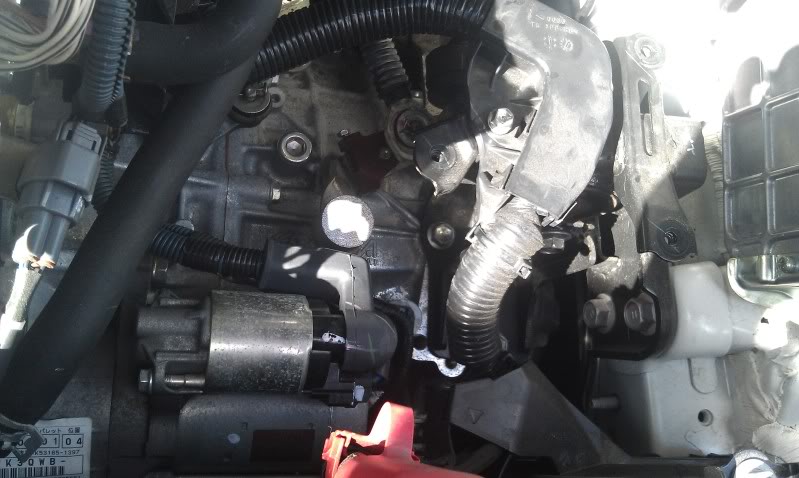

Ok here are some pics of the TRD short shifter install.... Pics arent easy to see really but look for the red pieces lol.
