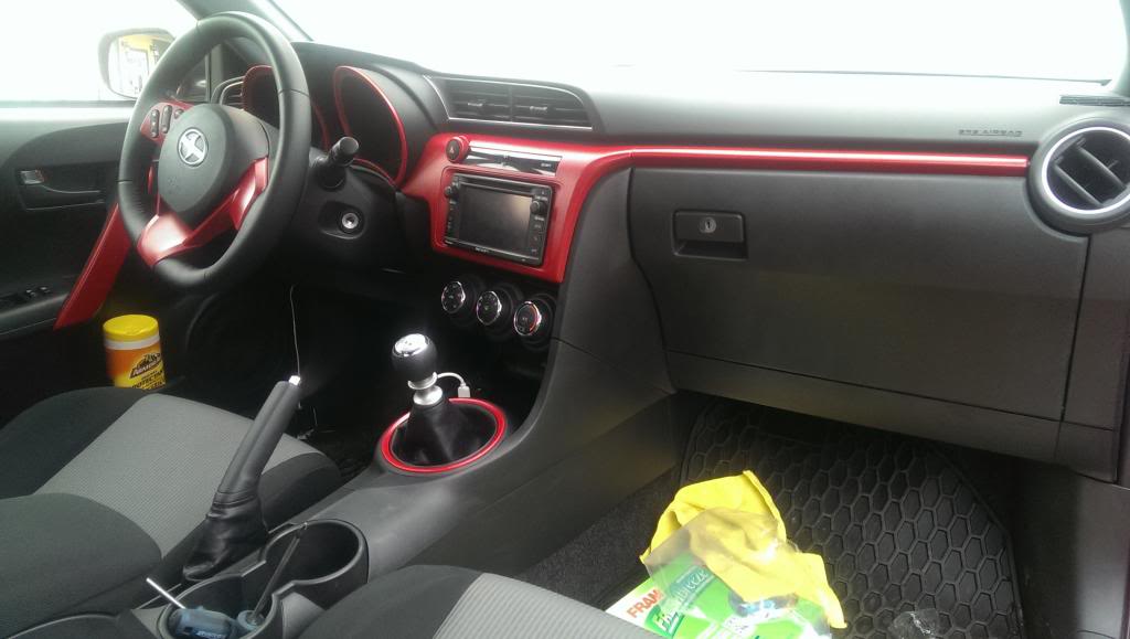

Next was plasti-dipping the interior dash panels (minus the top vents, looks like a PITA)

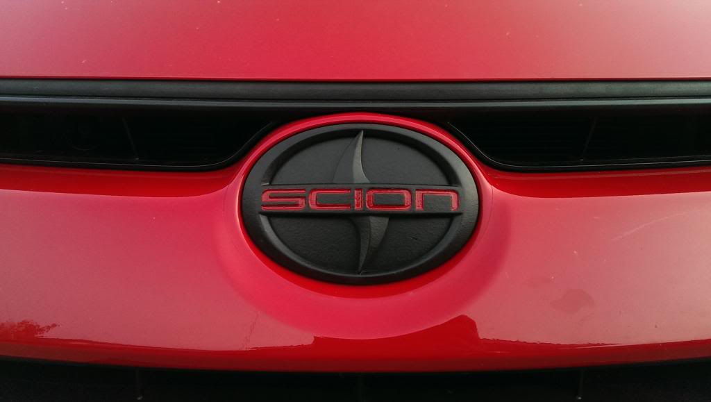

After that I blacked out the Scion emblems and tC logo, but I felt it was to much black so I used my paint pen to make the lettering red.

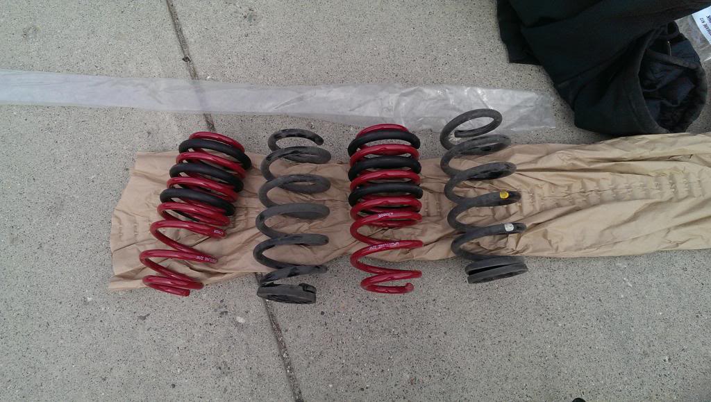

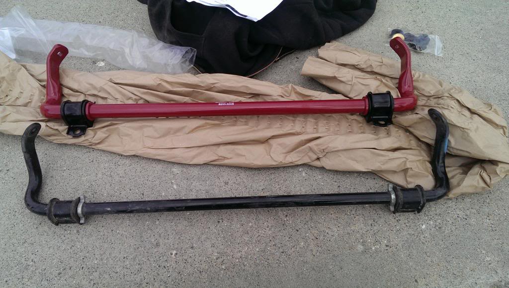

I finished my first mechanical change last Thursday when my eibach sport -kit arrived

My phone died before I could take any more pictures, and the front sway bar is a B___H.

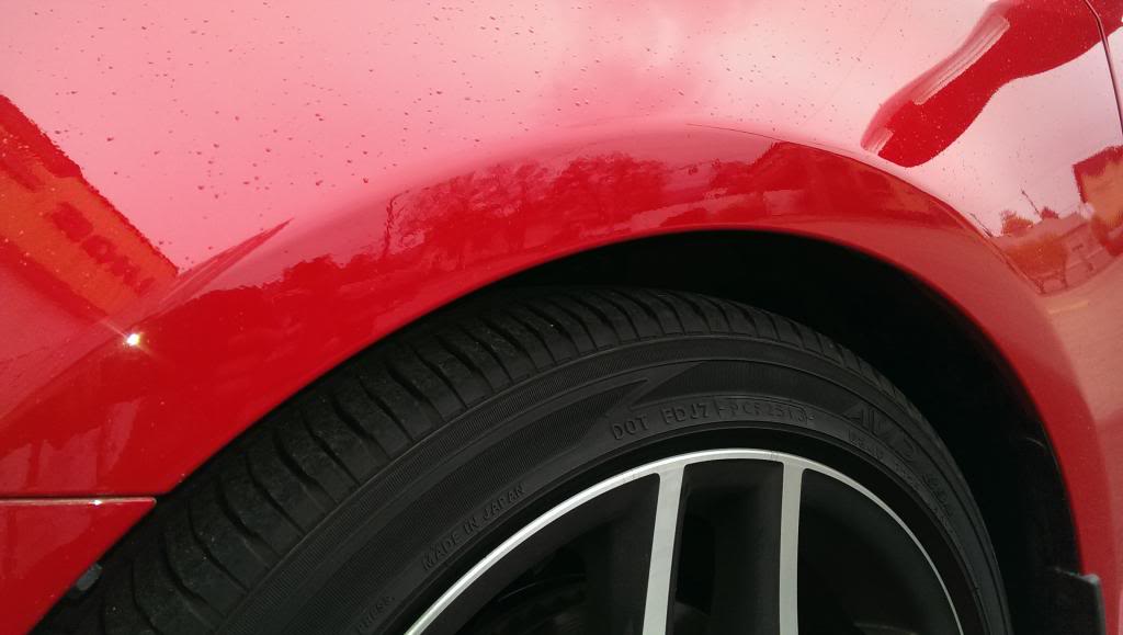

After Lowering. Also forgot to take photo's immediately before installing everything

Y was the sway bar such a _____ ? Heard it was a lot easier on manuals.
Old May 14, 2014 | 12:00 AM
CornerHugger's Avatar
Joined: Jun 2013
Posts: 50
You still gotta drop the sub frame on the driver side to maneuver the new sway bar in. I didn't have access to a lift when I did mine and it sucked

I didn't have to drop the subframe, I just undid the lower ball joint and one of the lower control arm bolts on the drivers side (can't take out the lower control arm bolt on the passenger side because the oilpan is in the way) and swung that out of the way, came out fine after that. But I had to re install the strut first or I would have likely over extended the cv axle.
It is possible that the transmission on an automatic would be in the way of taking the drivers control arm bolt out as well.

your car is looking real good! definitely a good job on the painted interior trim, i was wondering if you could post a couple more pics of the car with the new springs? im really debating on getting the Eibach springs, just wondering if itll be too low or not for my taste

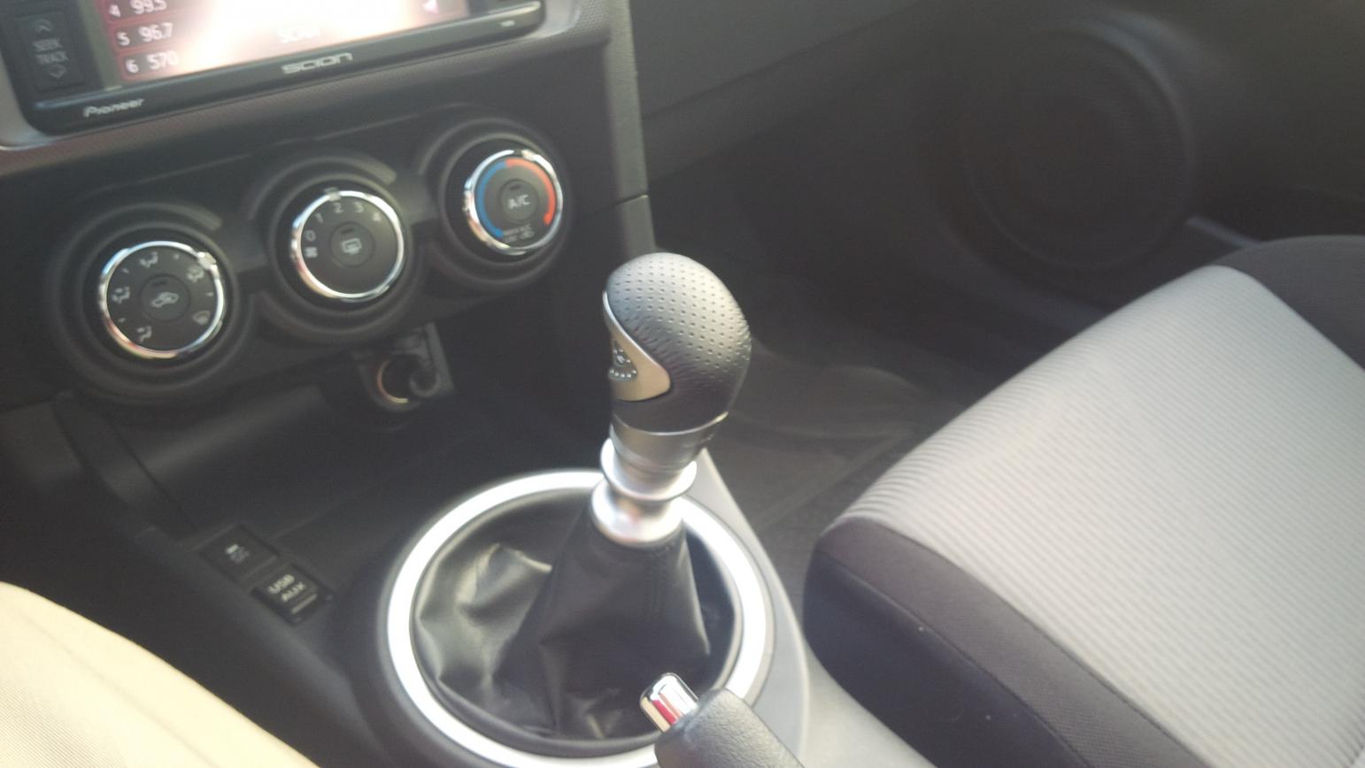

Really nice car and the interior looks great with this red accents you put... My only reccomendation is if you can change the crappy OEM shift **** for the weighted one. It looks way better and improves your shifting. I just get it around two weeks ago and love it (see pic).
Great Job man, congratulations!

@deloren the overall handling is much improved compared to stock, as to what made more of a difference, I can't say because I installed them at the same time. There is a small issue I am trying to deal with right now with a slight nocking sound from the front springs. Pretty sure I put everything together right. Also I'm not sure if it is limited to the 2014 or not, but the front swaybar does slightly contact the lower control arms on large bumps. I noticed in the instructions that the way the bar mounts is different than the way mine does, although it does mount to the same position. I have not had the car aligned yet, I was supposed to get it done Thursday, but I just ordered my adjustable rear control arms, so I postponed it until those arrive.

I have the knocking sound too with my sport lines but I don't have the sway bars (yet). I thought maybe I didn't tighten the bolts to spec (thought I did).

As I have not had an alignment done yet, I might pull the front apart on sunday and see if I can find the issue. At first I thought I put the swaybar links on backwards, but it doesn't look like it fits the other way. I am pretty sure it is just a coil hitting another one, but we'll see. Might try putting a strip or rubber in there or something.

U remember to put the spacer on before the nut on the strut bolt ? I have no noise on my trd. Bit in the rear if I go over big bump or pothole but it's rare and just a small clang. I'd start by double checking all bolts/nuts.

PS I'm on sportlines now. You need to put an isolator on second coil from the bottom on the inner side (closest to engine) on both front springs. The bottom coil and thus coil hit each other. I used 1/2" heater hose but it's quite thick. This will solve your noise issue.
