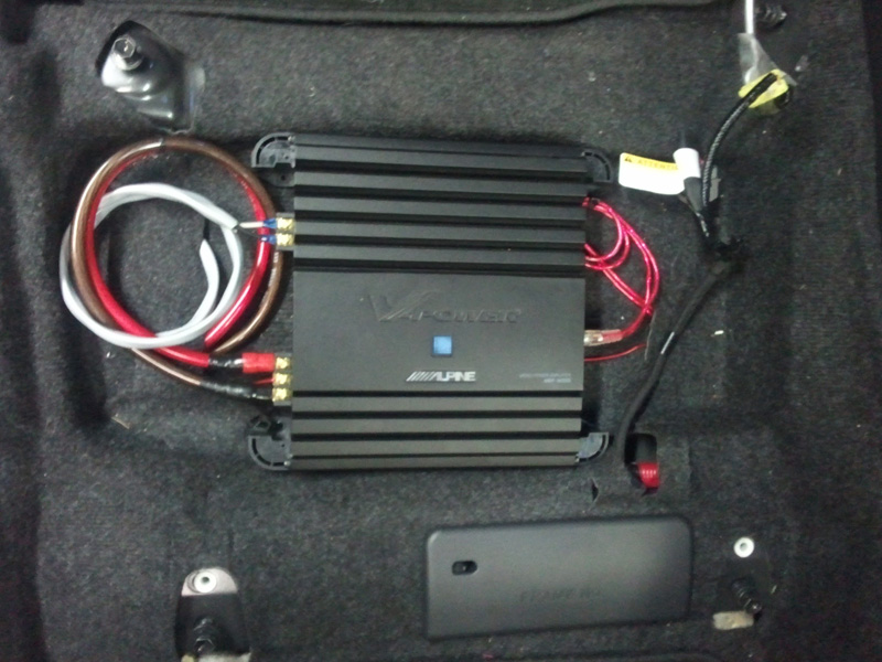

Installing my new Alpine 500W amp under the passenger seat. I could have completely tucked the wires, but I like to avoid sharp bends in thick gauge wire, and leave a bit of slack for future amp upgrades. Snugged the corners down with zip ties to the carpet, fits snugly and the wire terminals are all oriented perfectly. Grounded to the seatbelt bolt.

Everything is 100% hidden under the seat except for the looped wires, so that was fixed with some wire loom. Actually looks kinda cool

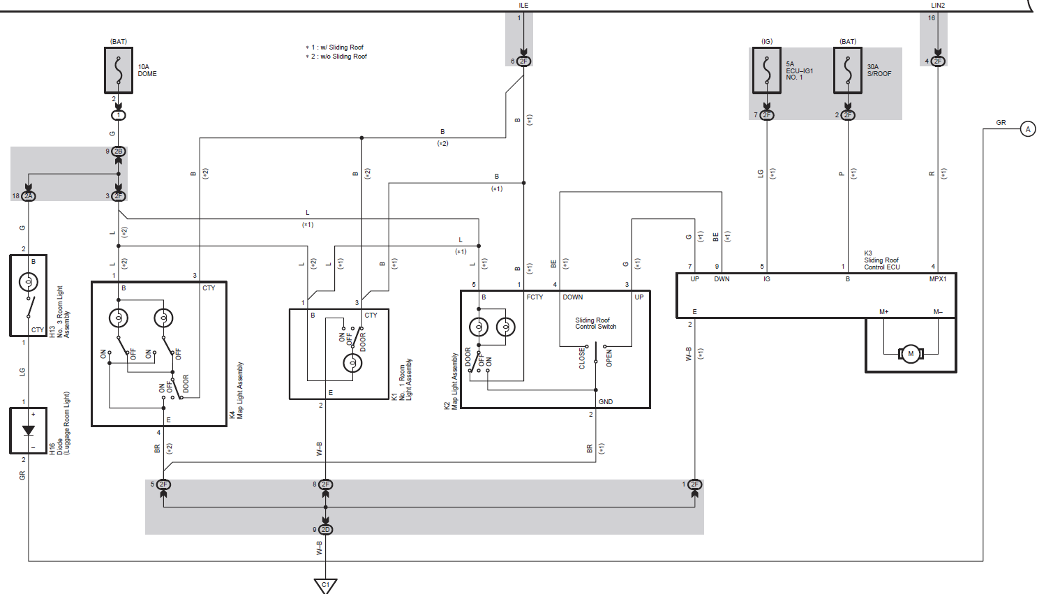

I've been doing some research on an interior footwell light project, and I have a cool idea. I found this picture in the factory electronic wiring diagram:
The dome light operation (fade in/out on lock/unlock, door, interior light) is controlled by the ECU with a varying ground. The ecu gradually grounds the door connection, making that cool fade effect. So I need to tap the LED strip positive wires into +12V constant, and tap into the blue wires at the top of the schematic for ground. These wires should be above the dome light. We'll find out tomorrow and I may post a DIY if it works!

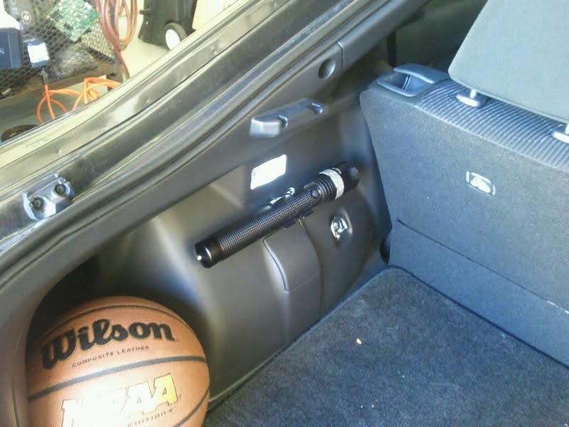

Installed a flashlight mount in the trunk:
