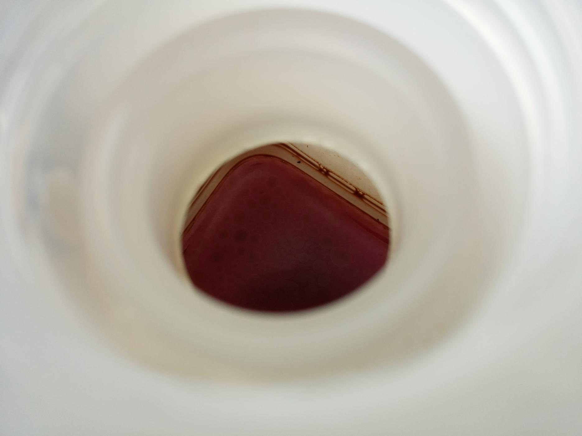

4500 miles. Found the leak!

Old Apr 11, 2014 | 07:36 PM
Laguna14's Avatar
Joined: Feb 2014
Posts: 37
Had the redline water wetter malfunction. Dont usewith Toyota pink! 481 bucks later i have to buy a new reservoir. Sending redline the bill.

Old Apr 12, 2014 | 03:12 AM
Laguna14's Avatar
Joined: Feb 2014
Posts: 37
Learned the hard way, it works with "all" coolant except Toyota. Redline is getting the bill and i've already started that. It coagulated and looked like motor oil or blown head gasket in the res. Took me 3 different cleaners to get it mostly clean. The res is so baffled that it cannot be cured with a flush. 481 was for a coolant flush, 2 jugs because it took 2 flushes to clean the residue, and a new reservoir plus labor. I decided to clean my res. myself to knock 279 off the bill and it's 108 bucks an hour for their labor cost

I used it because I've smelled hot coolant after parking it since day 1. No leaks etc. So i figured why not? Well.
Here's why not!
