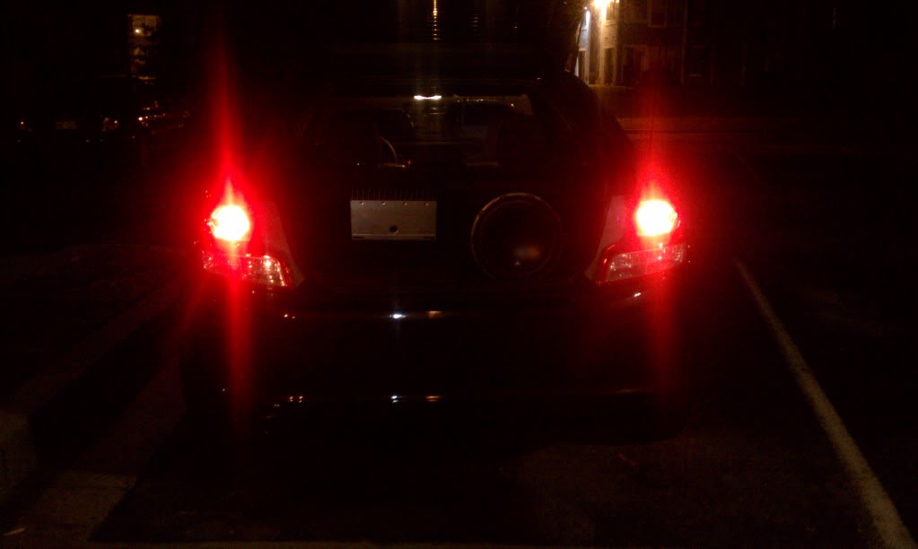

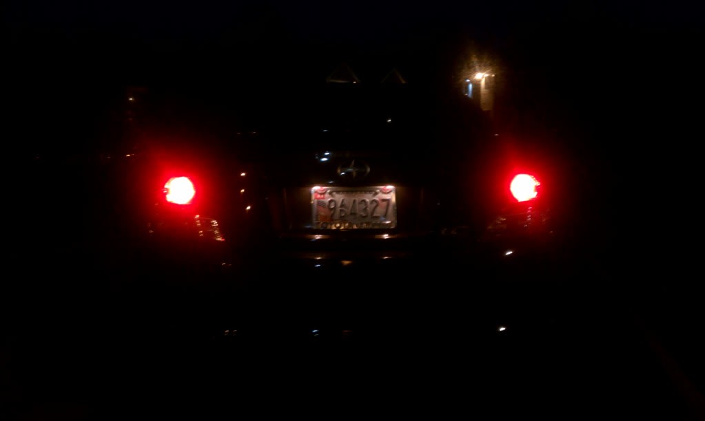

I have photos below, but they aren't very good. My girl took my camera and while my Evo takes great pics in well-lit environments, it is poor and inconsistent at night.
This first pic is with BOTH tails swapped out with the LEDs.
This next pic is with the LED in the left and the incandescent in the right. Any noticeable difference?
Pics are crappy, but are definitely accurately reproducing the relative brightnesses of the stock vs LED tails. What the pics are not depicting is the color reds being emitted. While it isn't a huge difference, the LEDs definitely make the stocks look washed out and cheap.
Yep, they look the same in the pictures. I look forward to some clearer pics where I can see the color difference. So what made you go with the 16 bulb lights vs the 48 bulb and 60 bulb ones? Was it just the price? You know if the ones with more bulbs give off more light?
