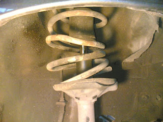

there is too much to say about how bad and dangerous (as in fatal) this is....
FWIW, these are one of many side effects of cut springs...
Looks more like a Heated spring instead of cut...
but thats a whole other poor mans lowering kit. lol.
Another wrong or misleading post by KidJustin...
Heating with a toarch will do that...cutting will not. Either one is bad news!
Old Jun 5, 2012 | 03:25 AM
2tCornot2tC's Avatar
Joined: Oct 2010
Posts: 1,075
Yes I agree that cutting springs is bad/wrong…but you would have been just as wrong had you posted a picture of a Smurf and stated that your face will turn blue if you cut your springs. That photo you posted was a result of someone torching a spring and not knowing what they were doing! BTW, do you live in East LA that you are coming up with all these slamming fails?
