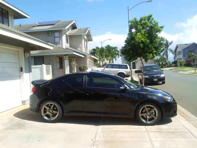

thanks for the replies guys. The set of tires i bought are Kumho Ecstas, brand new, and they are uni-directional. They are all rolling the right direction, I have personally inspected each tire/wheel individually and everything appears straight, no bends, no cracks, nothing. But if it is in fact Coincty like you say, then I suppose I wouldn't be able to tell unless I were to see my car rolling at highway speeds, right?
and a pic as requested for greenbeans
Love the wheels man! The conicity issue is not something you can see. It is measured on a machine at tire factories only. You will have to swap out tires to verify. Whomever sold you the tires should warranty them. Explain to them you have eliminated all other possibilites and you have a "plysteer" issue and you are highly unsatisfied. If this is truly your problem, the suspect tire or tires are trash and need replaced. The #1 cause of this is offcenter belts or tread. Once a tire is cured, it is nonvisible to the untrained eye.
