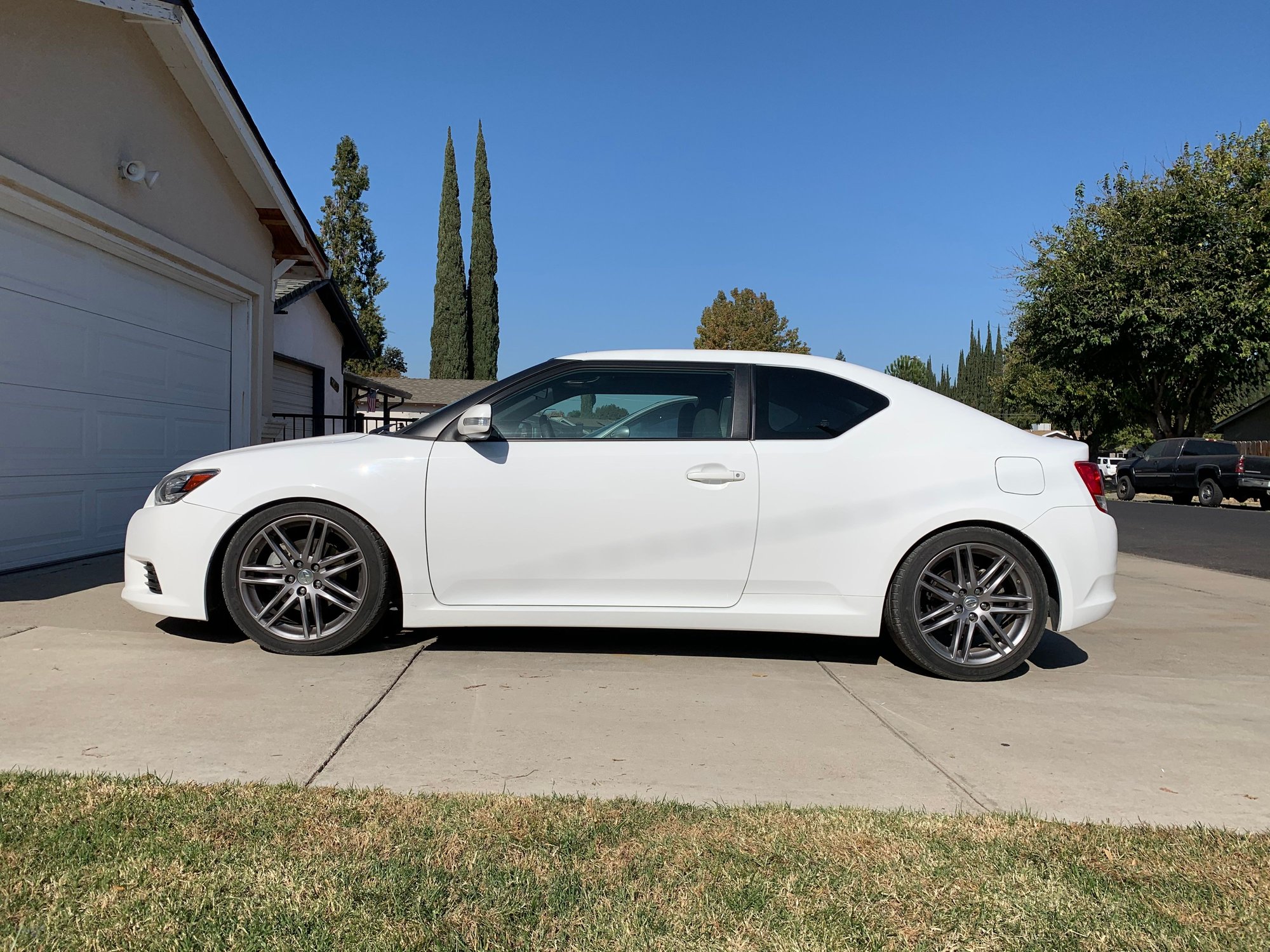

Need help on figuring out what spacer sizes I need to achieve a flush look on my 2012

Any info on your wheel/tire/suspension setup?
If you're all stock you'll want to space about 15mm-20mm but you'll need spacers with extended studs. The good quality ones (H&R) will set you back around $300 for the set. Most guys just opt to go with aftermarket wheels which look better and are usually lighter.

Oof, if spacers are that expensive I might as well just save up for wheels. Rn I’m sitting on coilovers with stock wheels.
