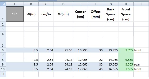

is there anyway to drop a car about 2 inches, have 19x9.5 rims, and not have any rubbing/issues WITHOUT fender rolling?
THIS IS FOR R5 wheels by 5 axis
the blue lines indicate the wheels you should get. you have a choice for the front wheels either 8.5 or 9.5
on TRD springs which is -1" off fron and rear u need 7.2cm front spacing to flush the front and 8.1 to flush the rear
so on a 2" drop those numbers will nees to be higher a bit
THOSE SEEM TO BE THE ONLY AND SAFE OFFSETS. IF u not satisfied you can alway use 5mm spacers!
id go with 8.5 and 9.5s because I dont like +45 offset, way to high, may be caliper clearance issues

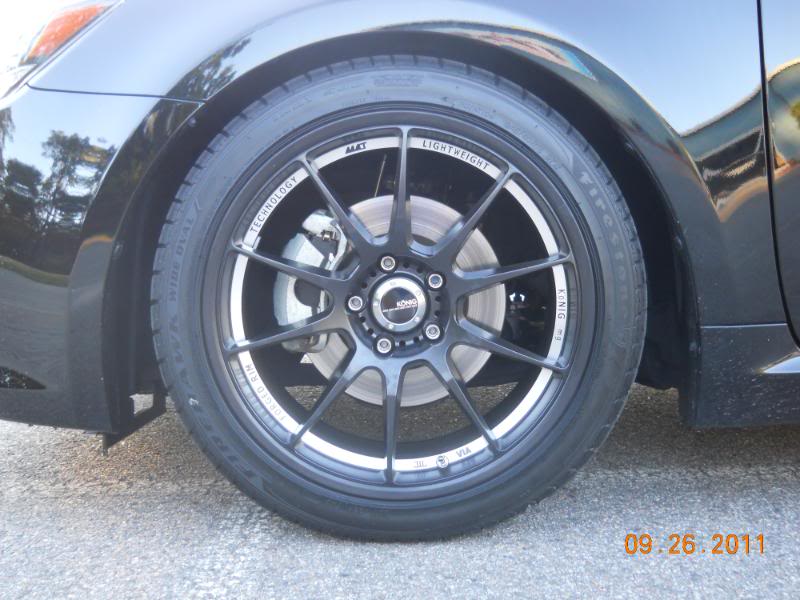

Caliper clearance is no issue period. Tons of room.
Mine are a bit pricey but well worth it. They are made using Enkei's MAT process which produces a strong lightweight wheel. Much stronger and lighter than XXR wheels. The MAT process is the next best thing to a forged wheel. My wheels weight around 18 1/2 lbs. each. Big improvement on performance, stock wheels are 27 1/2lbs for reference. So they are well worth the 900 bucks I paid. This is what I paid and who I bought them from, link below. These wheels come in silver, black and gold. Wish they had a bronze!!
http://www.ebay.com/itm/KONIG-WHEELS...item45fec4a17d
Great seller, I had my wheels in less than a week coming from California. I am in S.C.
