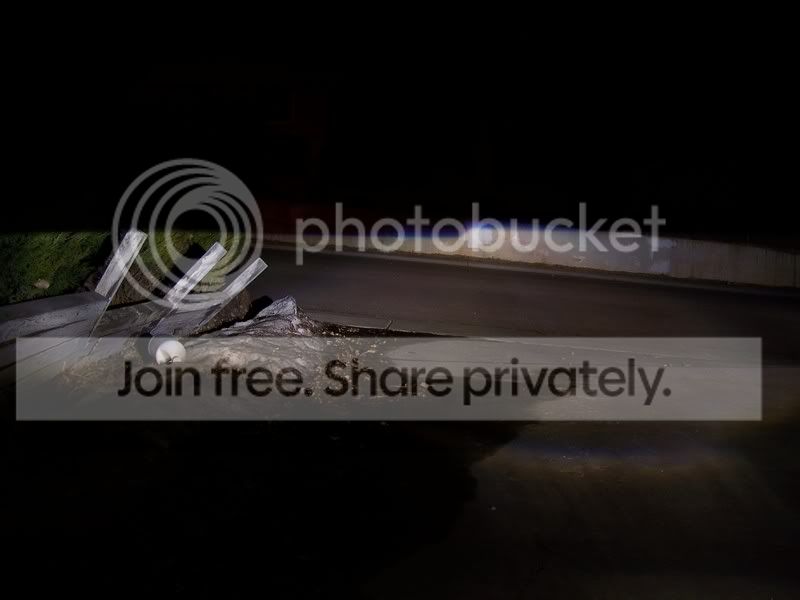

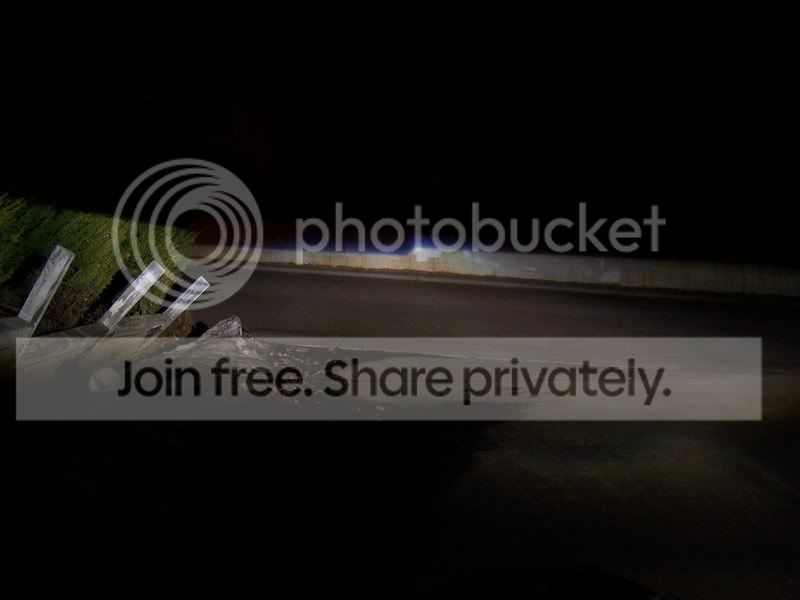

>>Mounted for rough aiming. Across the street is 70 feet. Street is sloping down to the right, but car is sort of level
~$100 pair of FX bi-xenon clear lens projectors with Philips 85122+ bulbs
$140pair of used Nissan Maxima D2S ballast
~$30 make your own wiring harness
$50 one used Left side headlight for test fit/drill holes
$20 pair of Home Depot 6" ceiling recessed light trim
total $340
But depending on where/how you get your projectors and ballasts, prices may vary.
You can also buy Plug and Play HID kits and use their ballasts with a $10 adapter to D2S, just sell the PnP bulbs. Maybe even use their harness.
