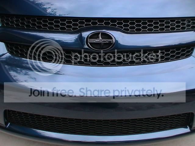

I painted the front and rear Scion logos Gloss Black, and they look AWESOME! I'll post pics soon.
-Pete

Kodokan_4's Avatar
Joined: Aug 2003
Posts: 372
From: Glendale, CA
-Pete

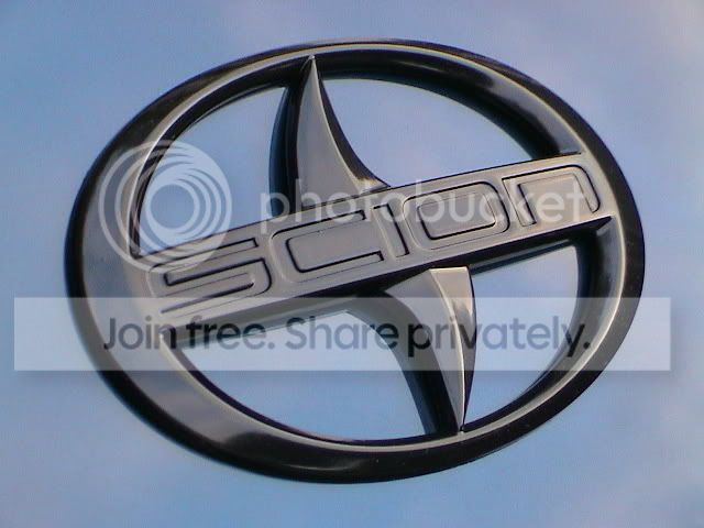

Yeah, but I want to repaint the rear logo first.
A small piece of dust fell onto it when it was drying. I'll get it redone and mounted by this weekend.
-Pete

-Pete
Old Apr 23, 2007 | 12:43 AM
HoldFastHope's Avatar
Posts: 556
From: Orange County, CA
Love the look, very jazzy looking. I'm too scared to paint anything, i'll probably mess it up somehow if given the opportunity. Did you just put a slab of paint on there or were there other steps you went through?
