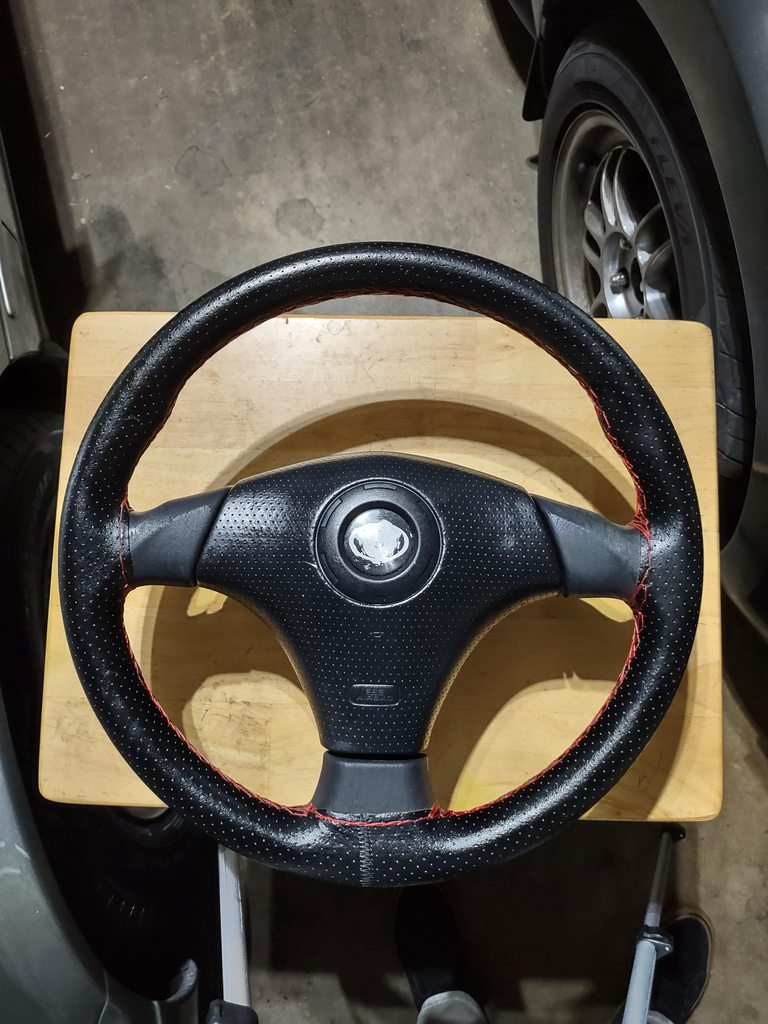

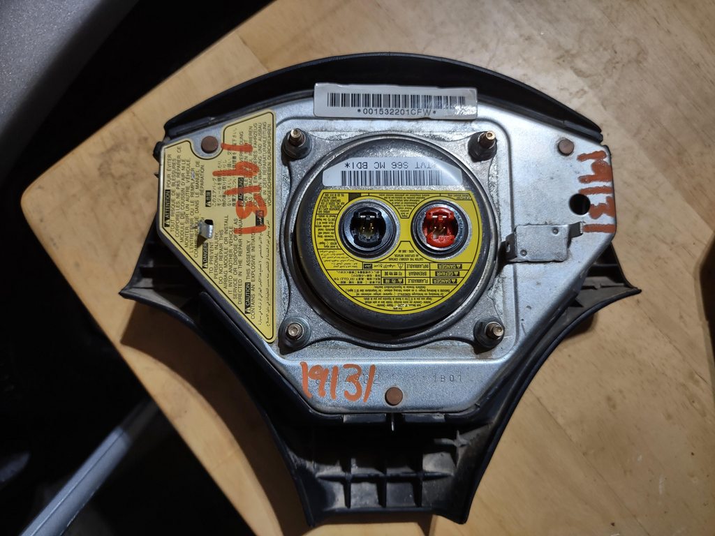

I really missed my old Matrix XRS steering wheel so I decided to swap a similar one in after doing a bit of research to make sure it was possible. I also added a better wiper stalk, too.
Pics of the haul (minus the airbag that I snagged this morning)
I had to swap the igniter from the xA bag onto the Celica one.
This was the completed wheel (I accidentally wiped off the Toyota logo while cleaning the wheel and air bag).
How it sits as of this morning. I will be coloring the stitching black as the previous owner's work wasn't great and getting a stick on vinyl to cover the silver splotch I created!

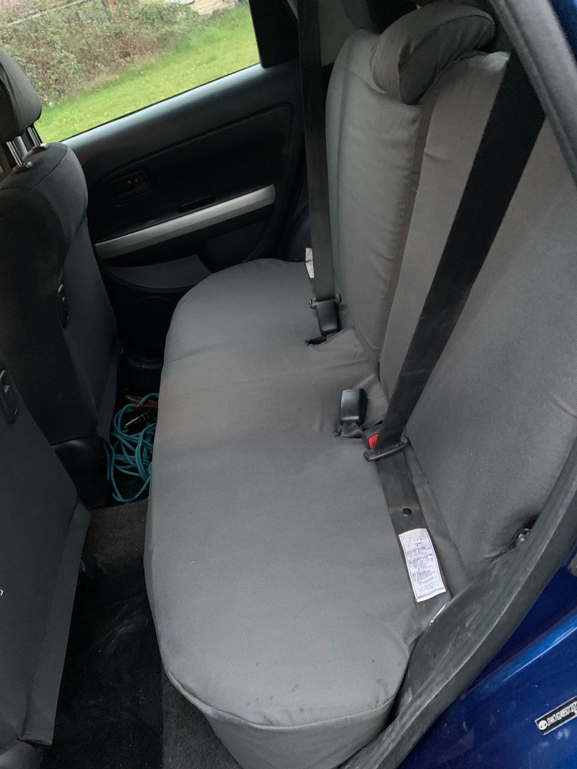

And the rear seat
cover.

No worries, man. I like the idea of the tinted quarter windows. Those seat covers look like a fantastic addition! I've got a 9 year old so having the seats covered is always a good call. She wasn't allowed to eat in the car at all when I had my LS400 lol.

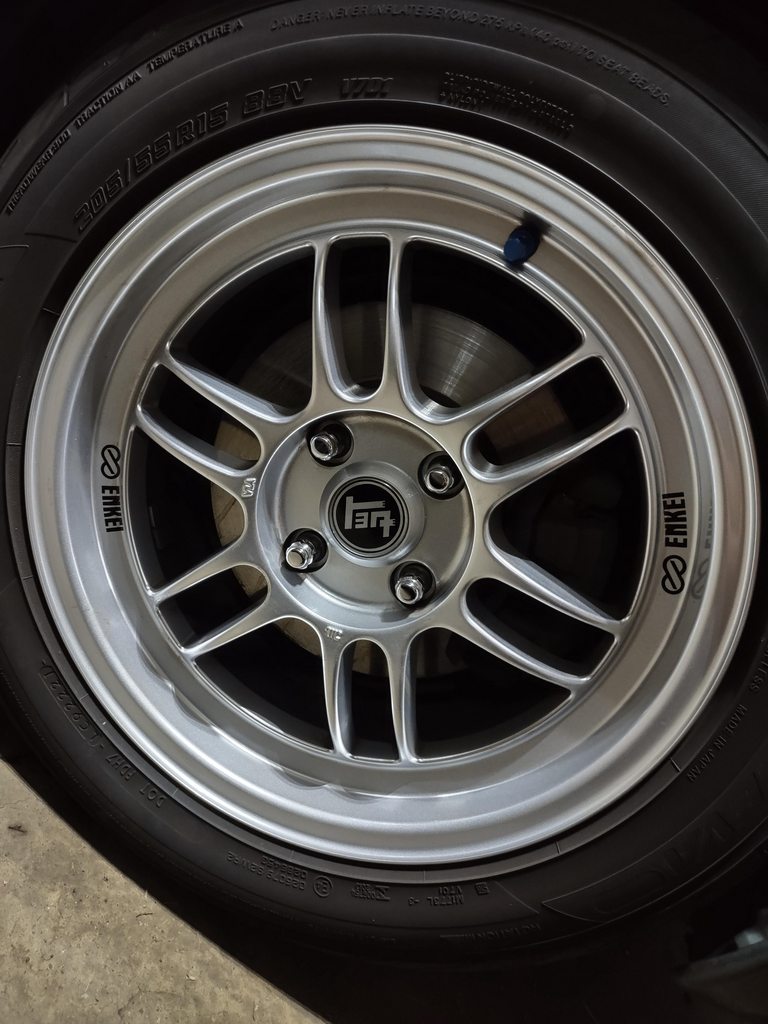

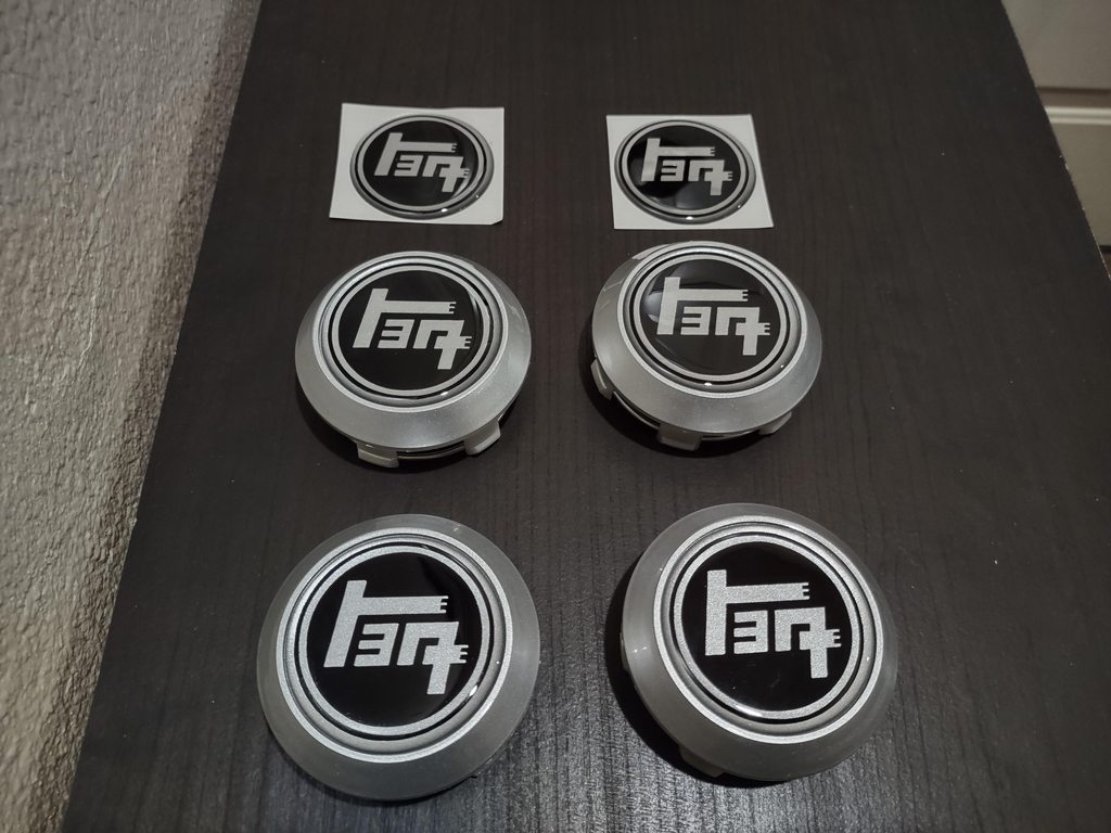

Got some custom caps made for my RPF1s. It's really annoying that Enkei doesn't make them for the 15x7 wheels.

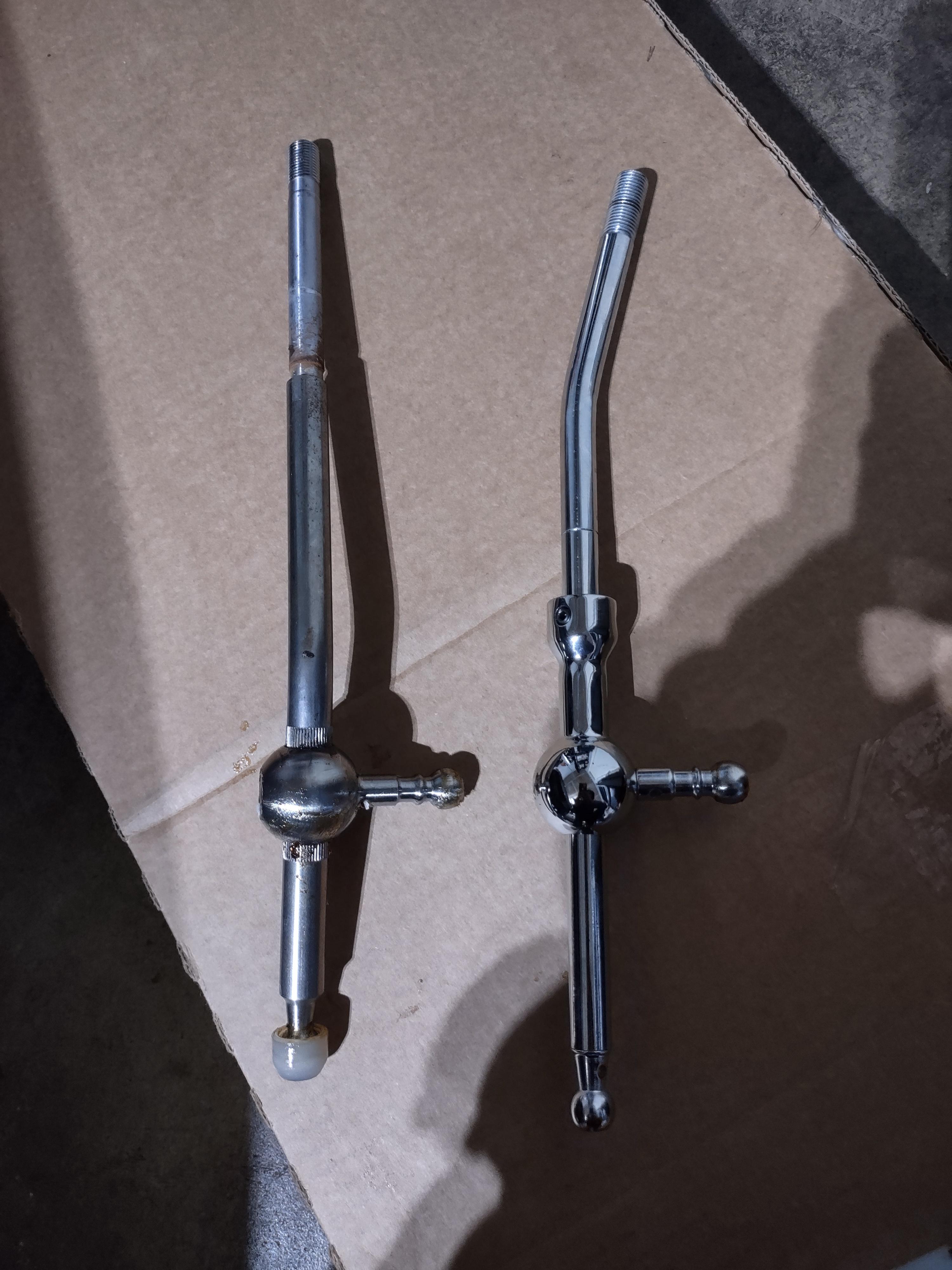

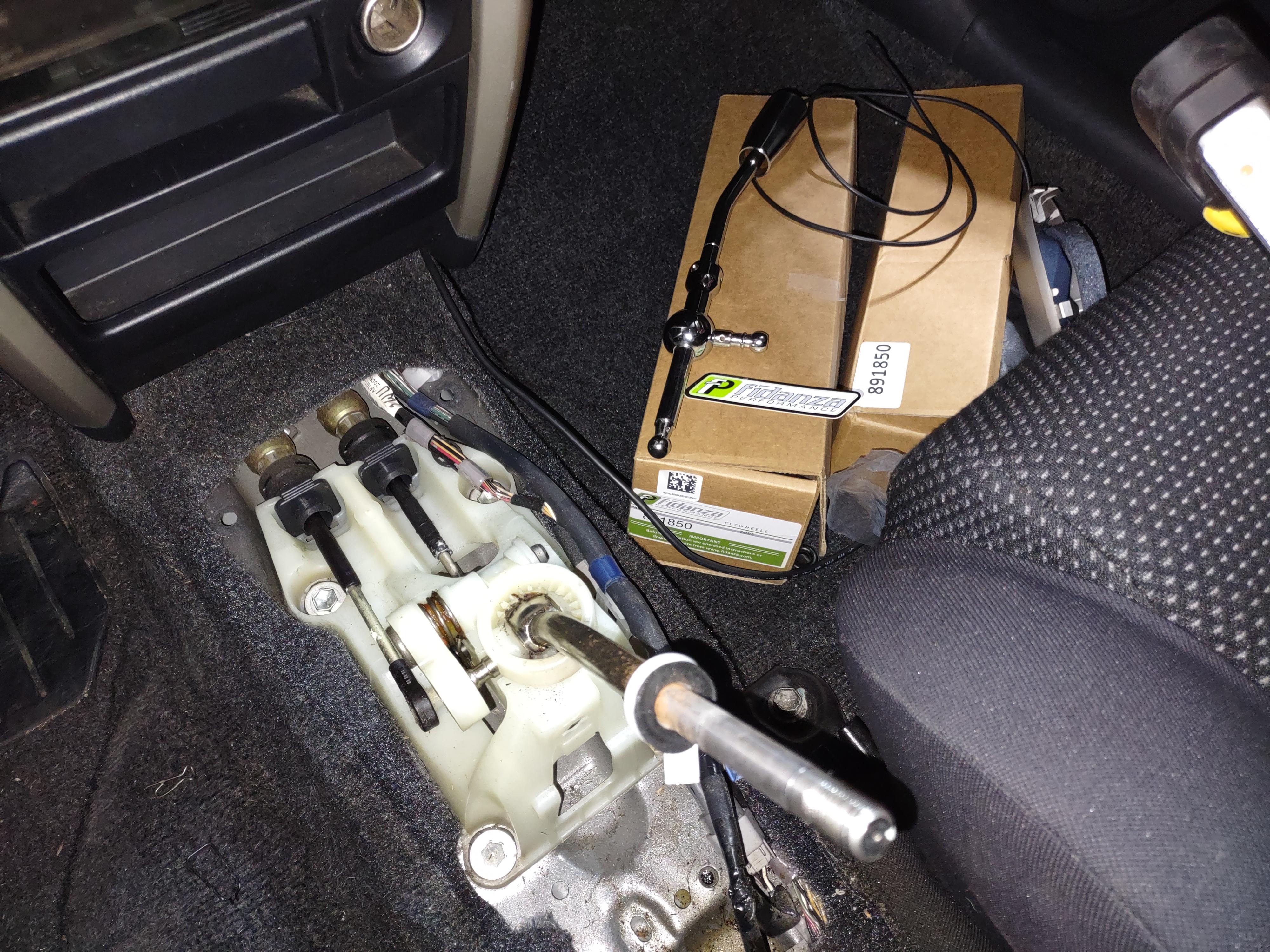

I got a Fidanza Short Shifter for Christmas and got to work on it yesterday.
I was worried about the angle of the Fidanza shifter but realized there are hex screws that allow for you to angle the shift **** in the correct direction.

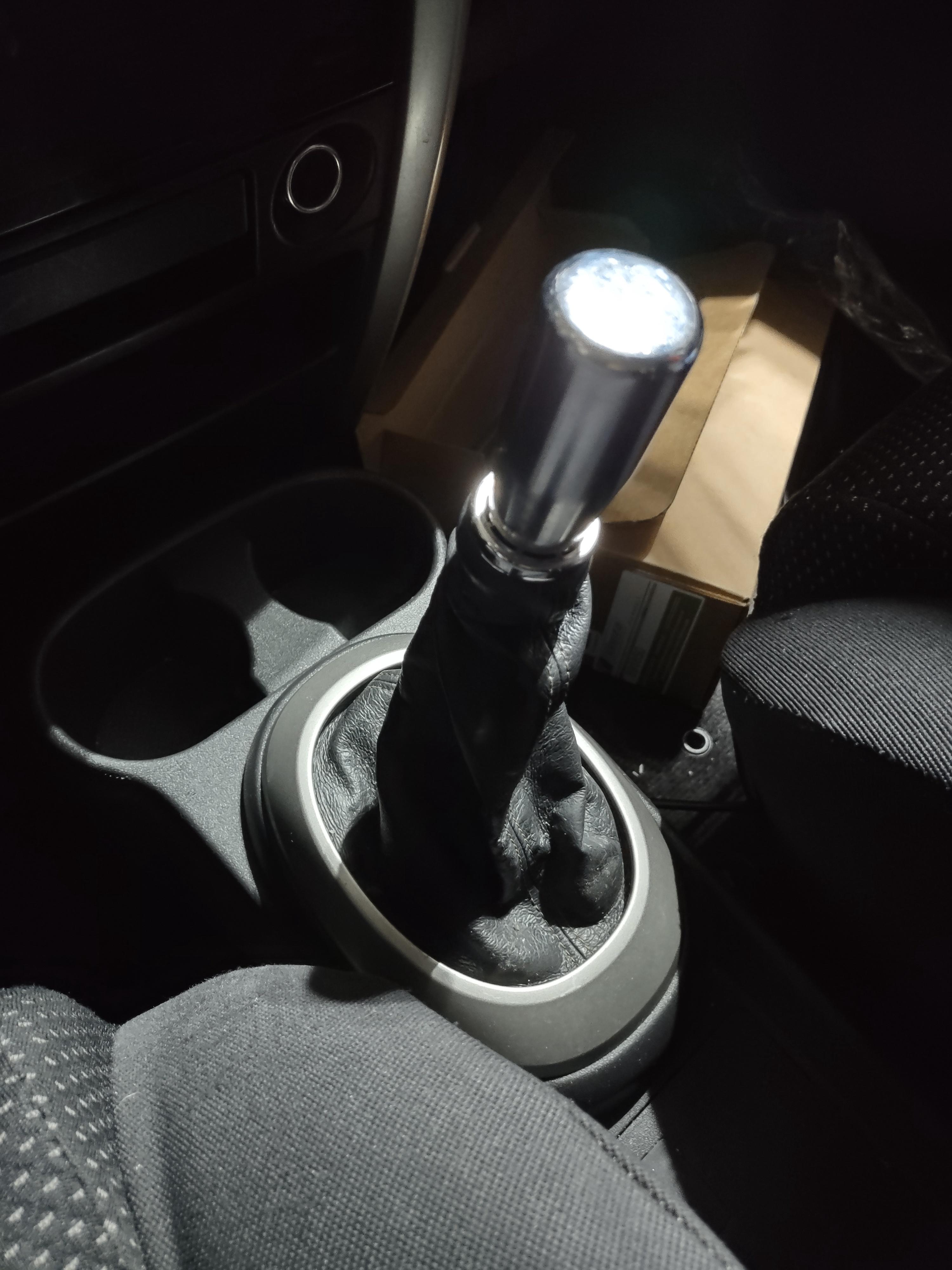

This is how it looks all put together. I'll probably continue running the stock **** because the Fidanza one is pretty small.
Couple of tips for anyone who may decide to buy that part:
1. When in first gear the bottom of the shifter will make contact with the lower right-hand side of the shifter cage so you'll probably want to grind away some of the material in that spot.
2. Be incredibly careful when you're removing the collar of the shifter to remove the metal part because it will happily crack on you (mine did a little bit and there is some noticeable play because of it). I will be ordering a new assembly, if I can find one, to fix that.
3. Buy shifter cable bushings to go with it. I opted for those first instead of a short shifter for my Toyota Matrix, years back, and I feel like it made a much bigger difference than the short shifter has in the xA.

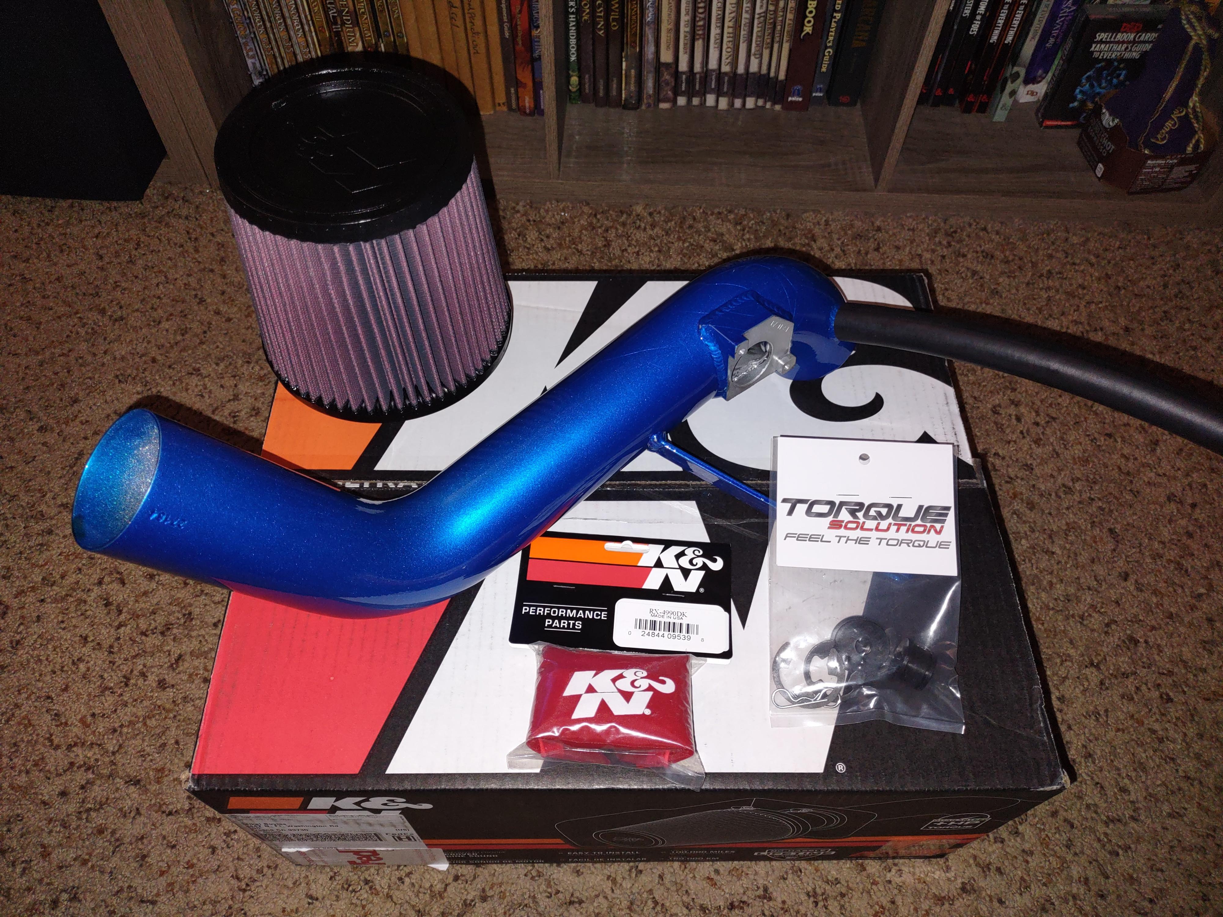

Got a few parts for the xA! Being in California and driving an '05 meant the K&N Cold Air Intake was the only reasonable option to buy. I also got some shifter cable bushings (finally). Since I was planning on taking the air box off to install the intake I figured that would be a good time to replace the bushings.
