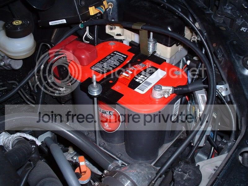

Ok, I just bought my Optima 25 red top and have installed it. First off, I love it. Second, I needed to put in washers & nuts for each side of the batter tie down. Does anyone have a better idea for a tie down? the Optima is about an inch shorter than the stock battery and causes this ghettofied (not raggin on the ghetto) problem under my hood and I want something more...... stable... better... know what I'm saying.

Instead of using washers. Cut the tie downs shorter and put a new bend where it needs to be and keep it looking right.

I bought mine at costco and it came with a spacer to make the battery taller just for these instances. The battery sites on top of it. So you don't see it really. Where ever you got it should have had it too.

I thought about this already, the tie downs don't have extra any more threads to screw down further. I was looking around at work for something to add more threads to the tie down, but no luck so far.

here is a pic of what I have to do right now. the nut at the washer is where the threads end.

I meant remove a portion of the lower section. Not the threaded part. Then duplicate the part you cut off and leave the threaded sections alone.

I have that same battery and I got it from Autozone. Mine totally came with a spacer. It was attached to the top of the battery.. You turned it over and bam! Spacer...
Have you tried getting contacting Optima Directly? They could probably find you one, I would think..

alright, my vendor just brought me the spacer today and the problem has been rectumfied.
