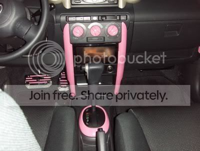

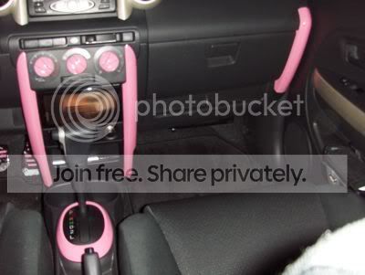

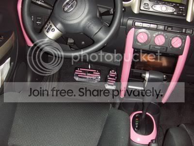

Default painted pieces...

I'll bet your hubby doesn't drive your ride that often!
Looks good, what did you use?

wow.....lol

great turn out!!

Looks really good, Nice job
Next you should paint the silver trims on the doors pink.
Old Jan 7, 2007 | 06:59 PM
USArmyWife1982's Avatar
Posts: 124
I'm gunna finish the rest of the silver in pink just having a hell of a time figuring out how to get it off the doors and the steering wheel and around the vents. i just figured out how to get it off the vents and steering wheel late late last night so it was to late to start sooooo thats my mission for today !!!

Damn! how did you paint those? was it hard? did your hubby do it ? I still have paint left from my engine cover so I wanna give these a try.
Old Jan 8, 2007 | 03:00 AM
Posts: 124
no i did em myself !!! hubbys in iraq so im sending him pics of the progress... For the plastic pieces along that compartment in the middle you just pop those off.. i got them off by gently using a metal putty knife as a lever to loosen them and just pulled em off. They are held on by clips so dont yank to hard or they might snap off. For the ones on the far edges of the dah by the doors, same thing just pry em off. The ones around the vent you need to take off the ac knocbs and unscrew those screws and then the whole piece will pop off using the putty knife as a lever... you will have to unhook the air and heat controls which coming form osneone who hasnt touched anything mechanical ever, was not that hard... if you need any help or info lemme know !!! and thanks for the ocmpliments cant wait to see yours.

USAW, I got some info on the door pieces.....you don't want to take them off... just take the door panels off and tape up what you don't want pink....I took mine off to put leather inserts in.... major PITA.

ohh good lord... thats one thing i dont know how to do lol is take door panels off.... hmmm guess i needa go look
Old Jan 8, 2007 | 04:44 PM
dugzilla's Avatar
Posts: 4,629
takes about 5 minutes,
philips head screwdriver 2 metal screws in door (one in handle and one by the release lever) and a plastic screw when you open the door in the front near the top.
take out the little plastic triangle that covers where the mirror bolts on and then all you have to do is pull from the bottom and it should lift off.
Then you have to unplug the wiring for the speakers and window/door lock controls. that's it.
Old Jan 8, 2007 | 05:00 PM
oldmanatee's Avatar
Posts: 3,167
From: Center Point, AL
the electrical disconnects are the hardest part.....and they are the easy latch types!
