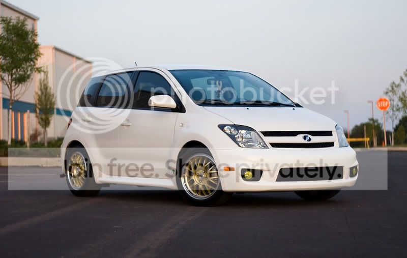

I've had 15's, 17's, and 2 sets of 16's. I love the ride quality of the 16's, and they don't give up too much in the handling department.

So in your opinion 16's give about the same ride quality as 15's? Also 16's with the correct size tires will maintain my mpg? Can you tell me is your xA lowered? What setup are you running to lower it? Also what grille is that? Thanks, B
Old Jul 11, 2007 | 01:29 AM
DeezNutz1833's Avatar
Posts: 346
From: PA
He has a stock grille, Tein S-techs, Yes you will maintain around the same MPG if you dont drive like a mad man. Yes 16's are the way to go in my opinion.

I'm running a 205/50R16 tire. My wheels are 15.5 lbs each. Much lighter than my winter setup which is steelies and a 195/60R15 tire.
I had Tein S-techs installed, I'm now riding on Progress coilovers. Pics to follow.

Old Jul 11, 2007 | 06:37 PM

Whoa dude, there's a couple of ghosts looking at you car! Lol, anyways, I'd say if you want to maintain comfort then get 16s but if you want to look good at the expense of some ride quality, go up to 17s. That's basically what everybody else said so I hope this thread has answered your questions.
