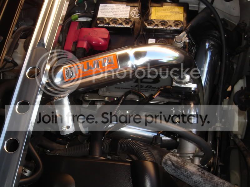

Here's my Fujita Cold Air Intake.

dang...that takes up alot of space. i used en Injen Short Ram.
how much space are you lacking? do you have another nut under the cai clamp on your battery? i would think you could just use 1 nut on top of the cai clamp to hold the battery down, you don't need both.
or maby ( in this order) thread one on then a washer then the cai bracket then another washer then the battery brace then the other nut. must be a way to tweek it and get it lower so you can still use your strut brace.
if none of this will work i think my tower brace is tall enough fo you its also cheep on ebay

Thanks for the input Carl! It does seem that I have to get a tall brace. The original brace was very low profile.
I was looking at a JIC tower brace. It's going for over $200!!! That comes in orange powder coat!

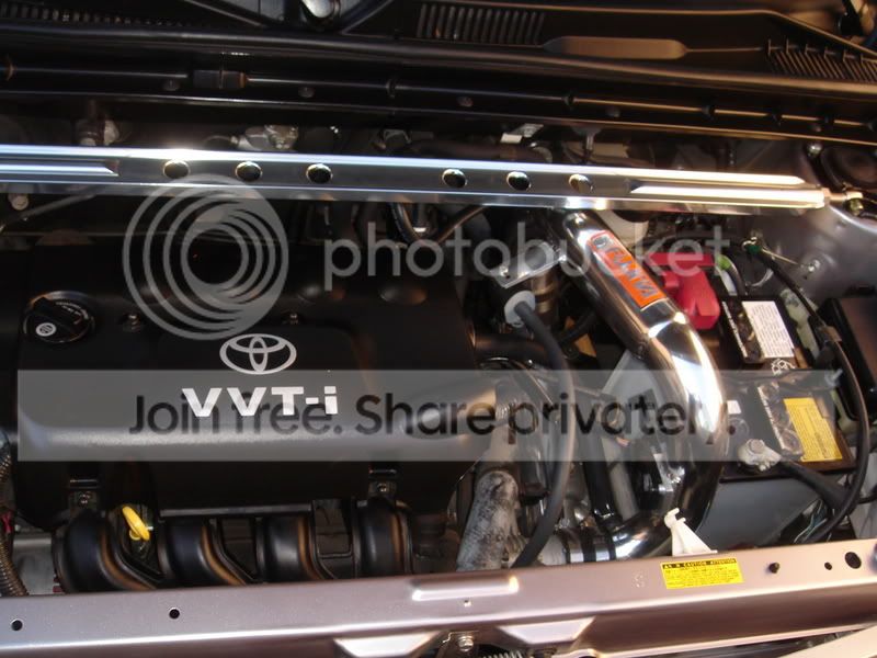

I'm glad you posted this. I won a fujita intake of my choice and didn't even think that the CAI might hit my APR strutbar! I guess I should look at the SRI too before I pick one!
IDK, do you think the CAI will fit under this thing? It's already pushing one of the hoses down.

thats very low profile. i don't think a CAI will fit.
do the SRI you'll like it better anyway.

Yes I did! Thank you again for the helpful tip! Sorry no step-by-step pics.
Took me an hour. Cut, assemble, and cut again. Be sure to clean out the metal debris before assembling. I stuffed the intake with an old shirt...finished cutting then carefully pulled the shirt out. The cotton shirt pulled most of the debris out of the intake.
I now have 3/4 inch clearance from the strut bar. No noticeable difference in performance by downsizing the pipe.
Now the strut bar fits! YAY!!!
